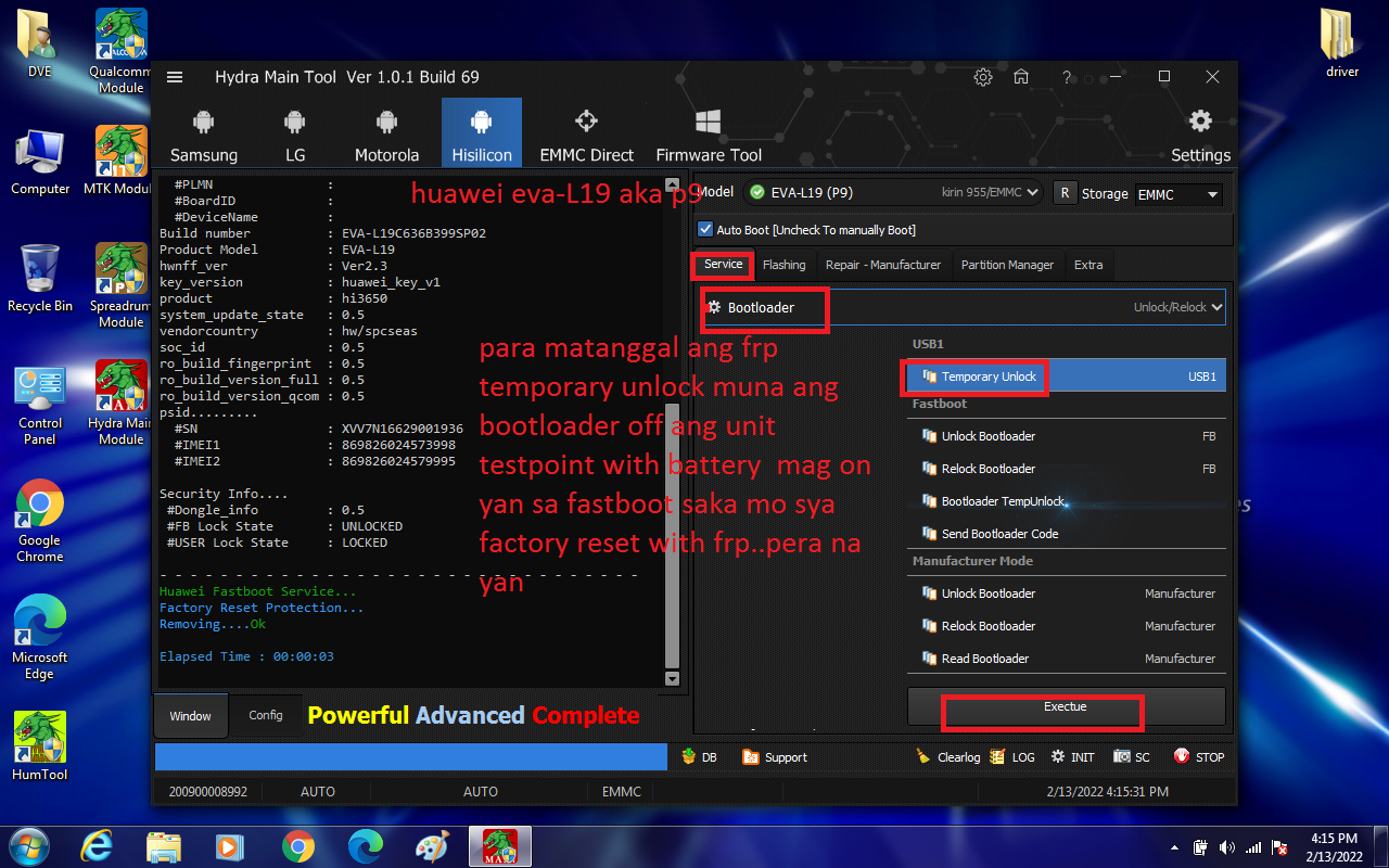

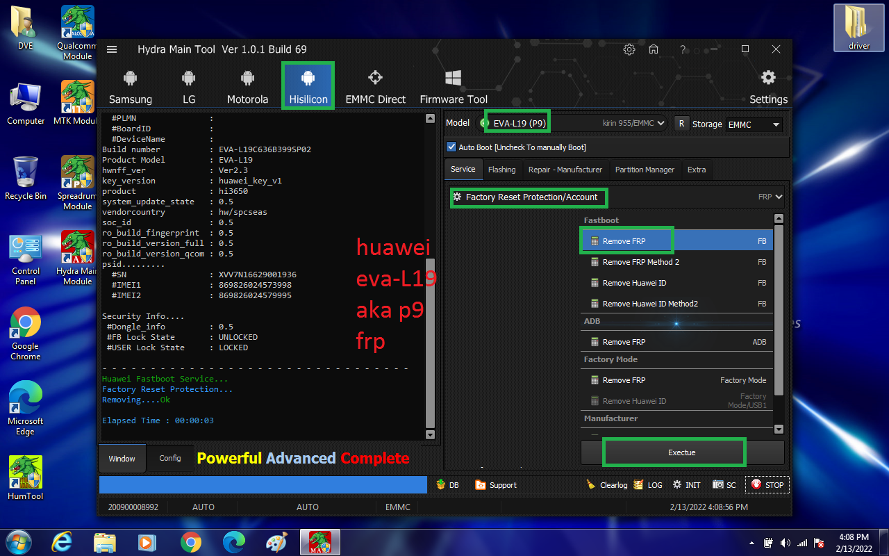

1.open hydra main tools
2.select model-eva-L19
=service
=bootloader--temporary unlock

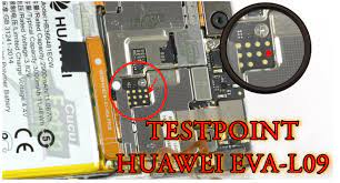

3.power off your phone =testpiont with battery salpak si usb wait mo mag on yan sa fastboot mode
=wag tanggalin ang cable balik kay hydra sa service
=factory reset protection/account
=under ng fastboot =remove frp then execute ,,,,,pera na,,,
=service
