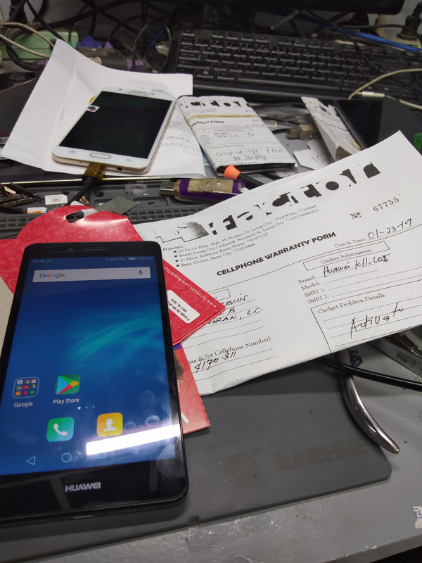

unit
huawei KII-L05
problem
unlcok to used to any sim card
thing need sigma dongle with pack 1&2

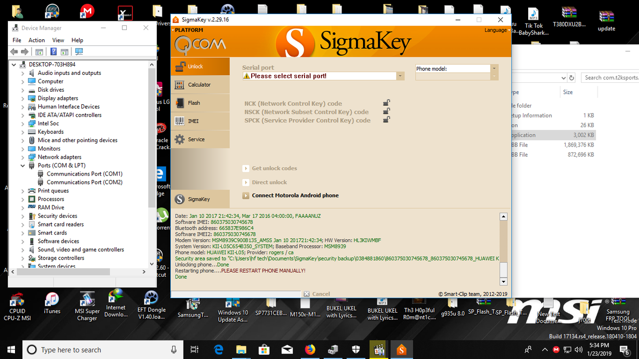

open sigma gui
go to Qcom tab
conect phone and select proper com then hit direct unlock..

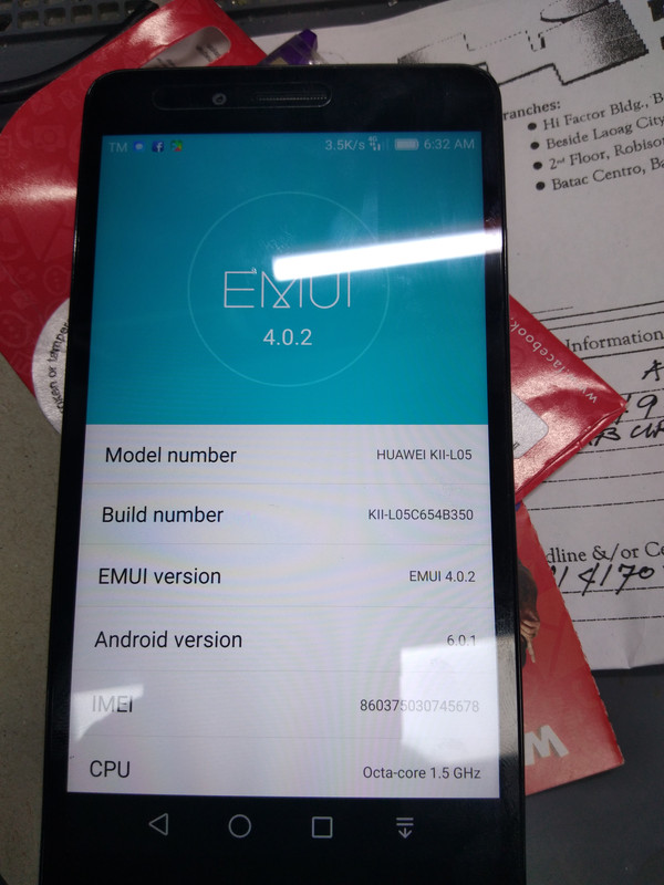

finish product
