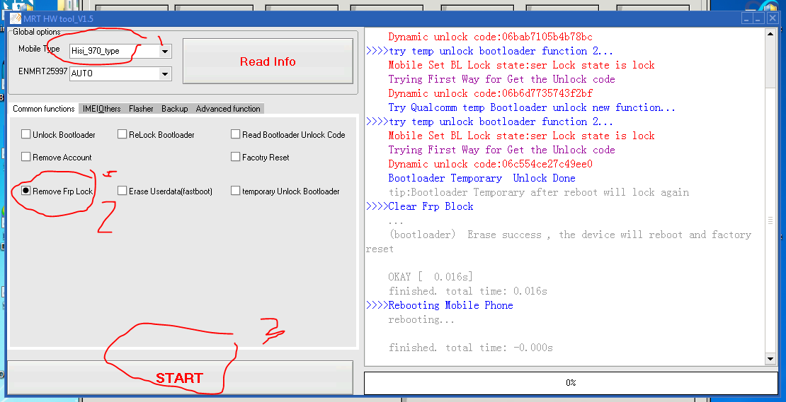

Tools :
MRT Dongle
Internet Connection
Micro USB Cable
Procedures:

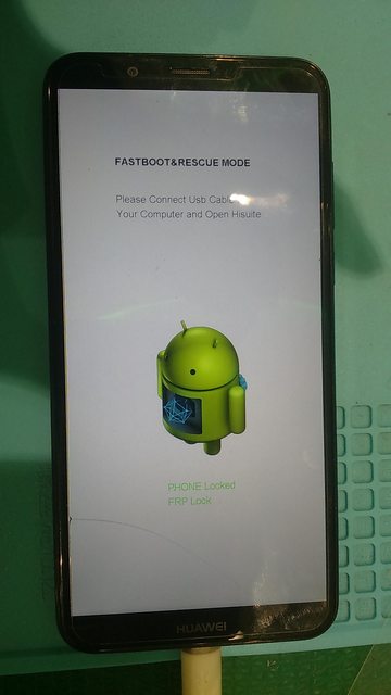

put device to FastBoot and Rescue Mode (press volume down then insert USB Cable)
Open MRT Software
click HW Tools
select mobile Type Hisi_970_type
select Remove FRP Lock
click START wait till Done..

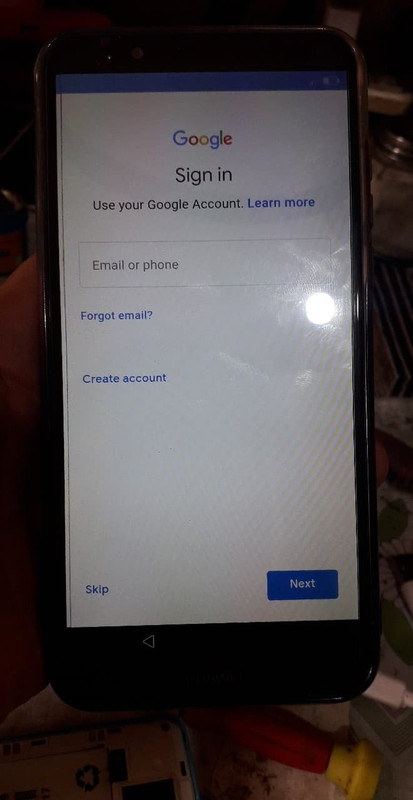

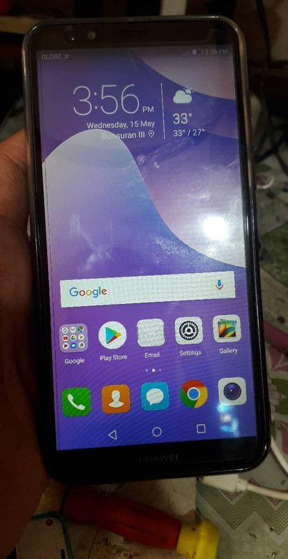

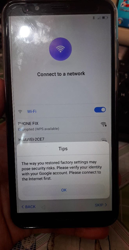

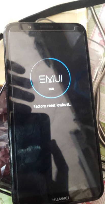

screenshots
finish product
