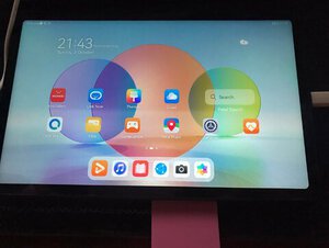

HUAWEI MATEPAD 2022
MODEL: BAH4-L09

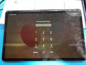

PROBLEM: PASSWORD
TOUCH NOT WORK ON RECOVERY
hindi makapag type ng YES
baklas likod

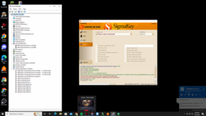

make testpoint
open sigma
select HISILICON platform
choose HUAWEI USB COM 1.0
select KIRIN number
click remove huawei id
