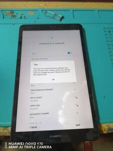

-Procedure

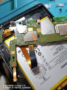

-Dissasembly the unit to make Testpoint
-Open Hydra Maintool and click HISILON Tab
-Uncheck Auto boot (Uncheck to manually boot)
-Select (Kirin 710) and (Initialize Factory mode)
-Then Test point the Phone without battery and then Execute

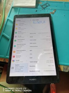

-Select Service Tab and select (Factory Reset Protection/ Account) Remove Frp on (Factory Mode)

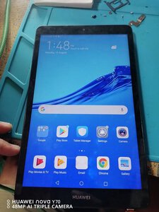

-Wait & Done
