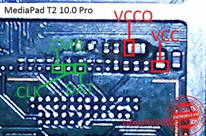

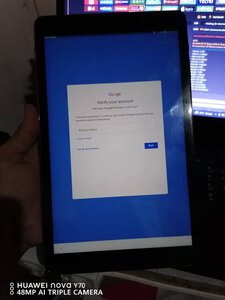

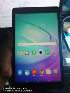

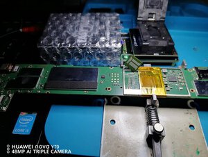

Needed Tools
-Easy Jtag Plus
-Emmc 221 Socket
-Try kuna mano-mano pero nega sigma key at octoplus lng pwede at iba pang dongle kaso wala ako..
-Procedure
-Disassemble the unit and remove Emmc Chip
-Clean the Pcb Board and Emmc

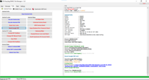

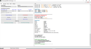

-Open (Z3x Emmc Filemanager) click Connect to Easy jtag tab
-Goto Tools Tab and click Reset FRP
-Wait Done
Eto mga boss Tested Rin isp niya....
