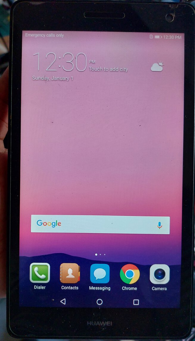

History: Ayaw gumana sa CM2... Success naman sya pero ayaw parin ma remove ng FRP.. Kaya I decided na e Flash nlng. Hndi naman nabigo..
LINK: https://drive.google.com/file/d/1Zg5i0s6IMneXW_5Bdt62Y3gjYK_Ue2k3/view?usp=sharing
1. Extract firmware.
2. Copy "dload" folder on your sd card.
3. Power off your tablet.
4. Then press volume up + down & power button together.
5. When logo appears release power button only..
6. Hold still both volumes until the installing update appears then release it.
7. Wait til finish..
Finish product:
LINK: https://drive.google.com/file/d/1Zg5i0s6IMneXW_5Bdt62Y3gjYK_Ue2k3/view?usp=share_link
6. Hold still both volumes until the installing update appears then realease it.
Finish product:
