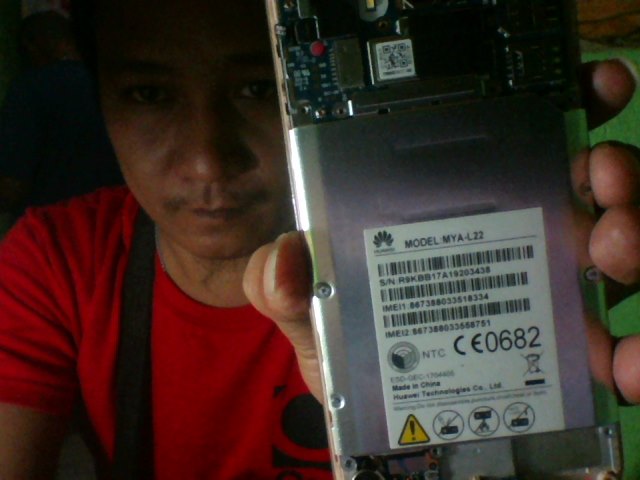

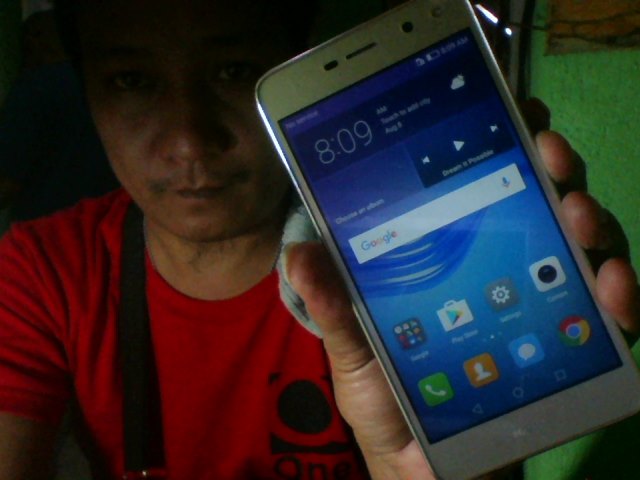

share ko lang mga boss

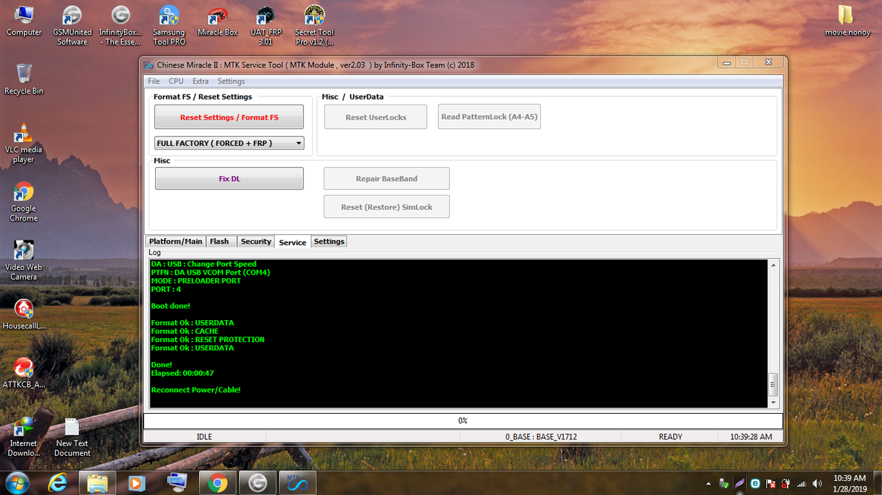

problem
PASSWORD AT FRP DONE
Code:
Card found : 28FA2B58 , v0137
Infinity-Box Chinese Miracle MediaTek Service Module [ MTK ] v2.03
Load IDBase v123080 Ok!
Operation : Reset Settings/Format FS [ v2.03 ]
1. Make sure device is powered off. Power off, if need. Wait 20 seconds after
2. Insert USB cable in phone
Waiting for device connection ...
PTFN : MTK USB Port (COM3)
MODE : BOOTROM
PORT : 3
Waiting BOOT ack ...
BROM : Skip ACK verify
BROM : Init BROM
BROM init passed!
    CHIP : MT6735 , SBID : 0x8A00 , HWVR : 0xCA00 , SWVR : 0x0000
    TYPE : LEGACY MTK
BROM : SecLevel : 0x00000001
BROM : SecMode  : SBC
BROM : BOOTROM
MODE : 0_base : BASE_v1712 | Manual : Disabled
Fail to disable Dog!
AGENT : Look for suitable BootChain in DA ...
AGENT : MTK_AllInOne_DA.bin
AGENT : Found MT6735
AGENT : MTK_DOWNLOAD_AGENT
    BROM : Sending 1st DA ...
BROM : DA sent
BROM :Transfer control to DA ...
    DA : AGENT started!
NAND : DEVICE NOT FOUND
eMMC : OK
eMMC : 150100514531334D420D318BD6D3B4C3
DAInf: 4 : 2 : 155
DA : EXT_RAM NOT initialized!
eMMC : OK
eMMC : 510001154D3331458B310D42C3B4D3D6
NAND : 000000000000000000000000
    EMI : DEV : INFINITY
    EMI : SRC : INFINITY-BOX_INTERNAL_EMIDB_v0
INIT : 0xBC : LP/DDR3 [ 0x00000000 :  [ 0 B ] ]
DRAM : DRAM: 0x80000000 [ 2.00 GB ]
    DA : DRAM ready!
DA : BOOT to 2nd DA ...
DA : Receiving HW info
       EMMC: 150100514531334D420D318BD6D384C3
       EMMC: VEN : SAMSUNG | OEM : 01 | DEV : QE13MB
       EMMC:
             BOOT1  : 0x00400000 [ 4.00 MB ]
             BOOT2  : 0x00400000 [ 4.00 MB ]
             RPMB   : 0x00400000 [ 4.00 MB ]
             USER   : 0x3A3E00000 [ 14.56 GB ]
       SRAM: 0x00020000 [ 128.00 KB ]
       CHIP : MT6735 , SBID : 0x8A00 , HWVR : 0xCA00 , SWVR : 0x0000 , EVOL : 0x0000
       RNID : C7E4F9BDB90D9FF017908E0321DD67C
STATUS : BLANK FLASH
BSTYLE : EMMC FLASH BOOT
DA : USB : FULL-SPEED
DA : USB : Change Port Speed
PTFN : DA USB VCOM Port (COM4)
MODE : PRELOADER PORT
PORT : 4
Boot done!
Format Ok : USERDATA
Format Ok : CACHE
Format Ok : RESET PROTECTION
Done!
Elapsed: 00:00:47
Reconnect Power/Cable!
salamat sa pag view. for reference lang mga boss
