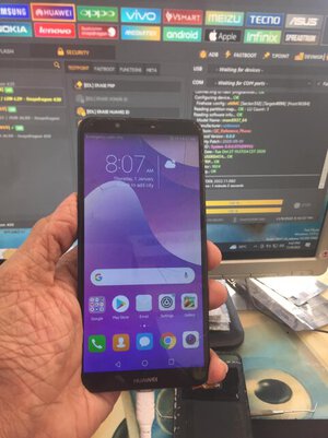

Huawei nova 2 lite LDN-LX2 frp
solution:
open unlocktool
select huawei y7 pro (2018)

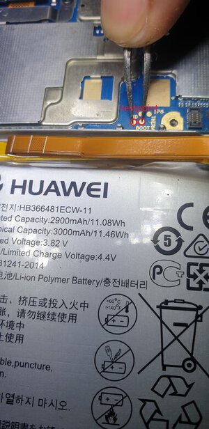

thick erase frp
testpoint muna bago insert usb cable
wait til done
tespoint
Salamat bossing kanina pa ako kong pano kase walang nova 2 lite sa ut y7 pro 2018 pala
