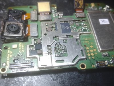

Received unit from co-tech
Status:

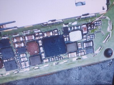

Wala na ung capacitor ng LCD FPC pin 1
Tapos naka jumper pa sa group ung pin 1
Action taken:
✅Removed Jumper
✅Trace positive lines then jumper from LCD FPC Pin1 papunta sa resistor.(please refer sa pic about sa location ng jumperIMG_20221221_223039_HDR.jpg.)
