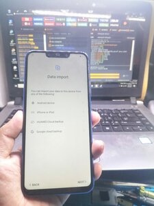

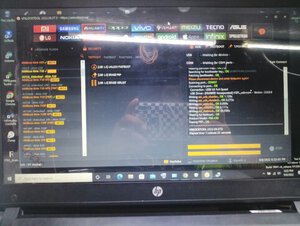

open unlocktool
select huawei
click hisilicon kirin 710
then click Erase Frp

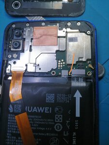

remove back cover via TP to boot
than click start a
atntayi matapos mag automatic reset sya
