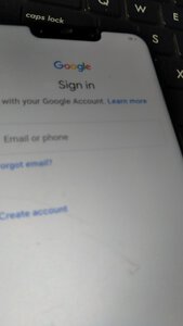

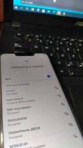

select huawei tab
select Hisilicon Kirin 710[FRP]
select testpoint tab
select [USB 1.0] ERASE FRP

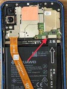

Remove battery cover
Test point

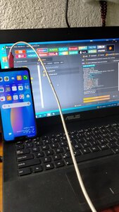

Insert usb
Done.
