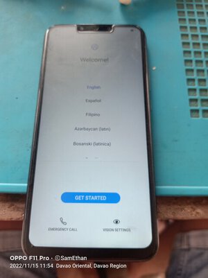

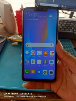

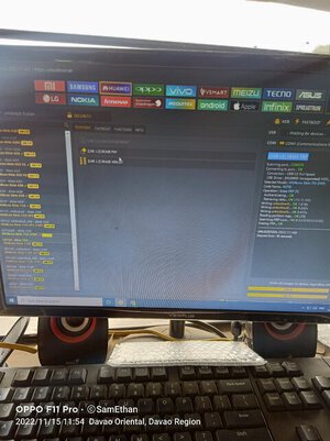

ETHAN16 Registered Joined Jan 10, 2022 Messages 69 Reaction score 39 Points 201 Location rizal street mati city Nov 15, 2022 #1 ACTION TAKEN: 1.OPEN UNLOCKTOOL. 2.OPEN HUAWEI TAB. 3.SELECT HISILICON KIRIN710 (FRP) 4.SELECT ERASE FRP. 5.TESTPOINT.SALPAK USB 6.DONE. Sana makatulong!!

NTCOMSHOP Registered Joined Dec 10, 2021 Messages 48 Reaction score 18 Points 201 Location Virac Catanduanes Nov 23, 2022 #3 kaya bah yan dol i openline
ETHAN16 Registered Joined Jan 10, 2022 Messages 69 Reaction score 39 Points 201 Location rizal street mati city Nov 23, 2022 #4 NTCOMSHOP said: kaya bah yan dol i openline Click to expand... frp lang kaya boss sa unlocktool, openline negative..
andrew Registered Joined Jun 22, 2014 Messages 110 Reaction score 43 Points 201 Location Novaliches Quezon City Nov 28, 2022 #5 harmony cable gamit mo dito boss?
ETHAN16 Registered Joined Jan 10, 2022 Messages 69 Reaction score 39 Points 201 Location rizal street mati city Nov 28, 2022 #6 andrew said: harmony cable gamit mo dito boss? Click to expand... hindi boss
