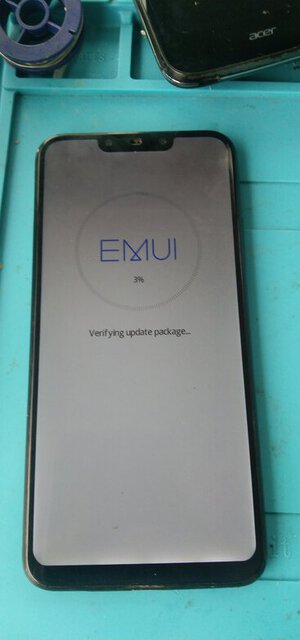

3rd... turn off mo unit then sabay pindot volume + and - then power button
4th.. antayin mo lang automatic na mag flash yan sa system hanggang matapos

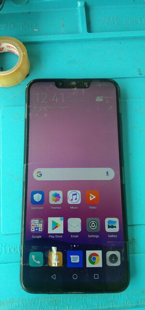

see attachment for legitimacy..
