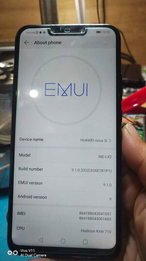

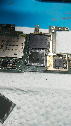

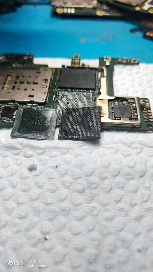

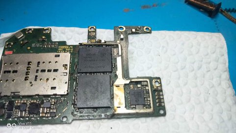

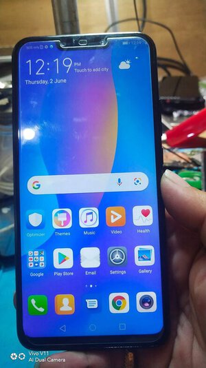

History no power nabasa mga boss..
Power supply reading 0.128 when power switch pressed and steady.
kaya cpu issue or ram..
kaya reballs kaagad at di naman nabigo.
sana po makatulong..
