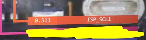

SET ANG TESTER SA DIODE MODE
NORMAL NAMAN ANG MGA NASUKAT KONG READING SA MGA PIN NG FPC NI FRONT CAM MALIBAN KAY ISP_ SCL1
DAPAT AY MAY MASUKAT AKONG 0.511 SA KANYA PERO ANG NASUKAT KO NA READING AL OL MEANS OPEN SIYA
PROBLEMA HINDE COMPLETO ANG RESOURCES NI BORNEO KAYA NAG ASK AKO SA IBANG TROPA KUNG MAY IBA PA SILANG GAMIT NA SCHEMATIC
AT BINIGYAN NILA AKO NG KOPYA GALING KAY ESTECH .
BASE SA ESTECH SCHEMATIC MAY DINAANAN PALA SIYANG ISANG RESISTOR AT PAG TINGIN KO SA UNIT NA AKING HAWAK
PUMUTOK PALA UNG RESISTOR AT HINDE KO NAPANSIN KASE NATAKPAN NG DUMI
PUTOK SIYA KAYA PALA HINDE NAG ENABLE UNG CAMERA KASE WALANG NAG BIBIGAY NG SIGNAL SA KANYA .
KAYA GINAWA KO AY KINUHA KO UNG ISANG NOVA 5T KO NA SCRAP AT INILIPAT KO ANG RESISTOR NA MAY VALUE NA 10.3 OHMS
PAG TAPOS TESTING NA KUNG GAGANA NA BA ANG FRONT CAMERA
GUMANA NA SIYA HEHE YAN LANG PO SALAMAT .​
