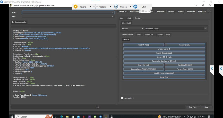

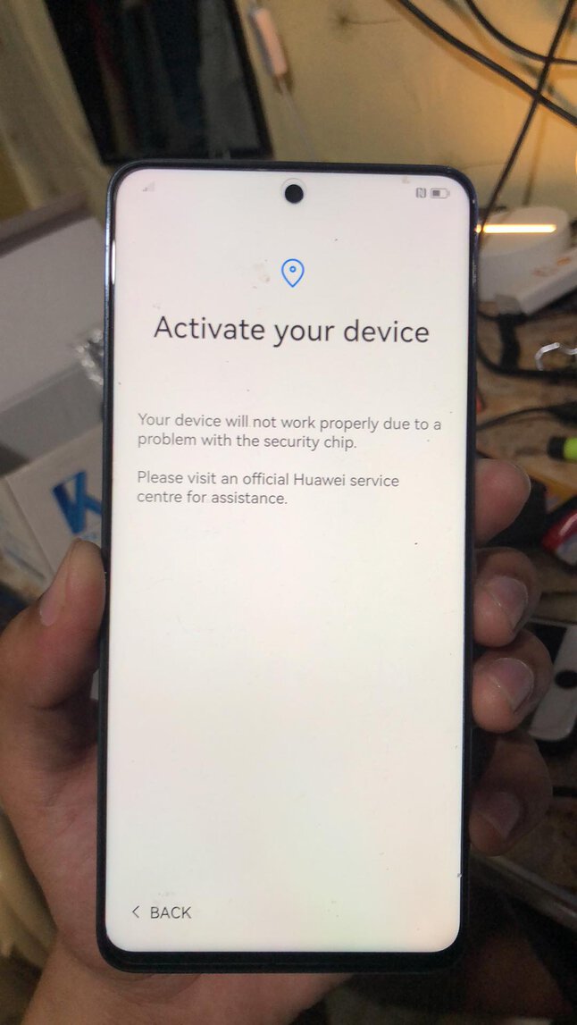

Issue: Huawei Id naging Chipdamaged
-Procedure

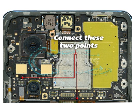

-Buksan ang unit para as tp
-Select qualcomm tab
-Select Brand Huawei Model Jln-lx1
-Click Chip Damaged tab
-Make testpoint with battery
-Wait & Done

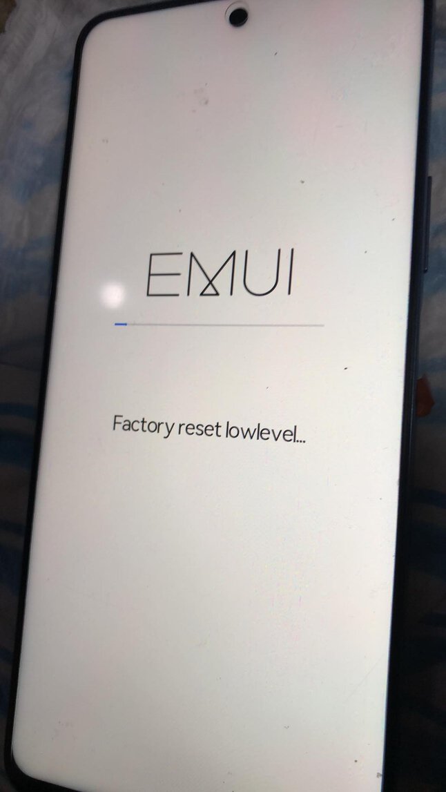

nakasulat sa screen sa ahalip na huawei id hinanahanp nakalagy "chip is damaged" mdlas ito pag mtaas ang patch ng tatangalan ng huawei id even kahit simpleng reset ganyan naging issue.
