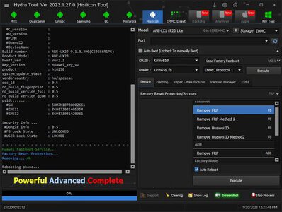

Open Hydra Main Module
click hisilicon tool
select ane-lx1 (p20 lite)
connect battery

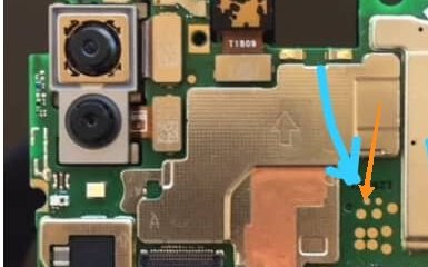

Connect TP
1 Choose Factory Boot
2 Click Load Factory Fastboot
3 Click Execute
4 Choose fastboot
5 click Factory Reset Protection/Account frp
6 Execute, Done :)
