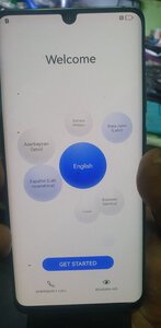

Share ko lang itong huawei P30 Pro

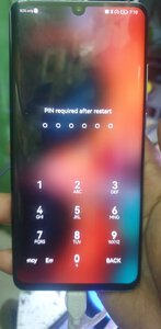

Password problem
Una Reformat ko muna ng manual
Using Volume up and power botton

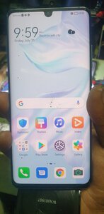

After ko matanggal ung password
May FRP or Google account

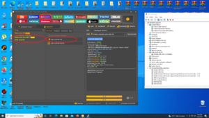

Kaya salang ko na siya sa UnlockTool

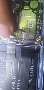

Need Ng Testpoint & harmony TP. Cable
Procedure
1.Open UnlockTool
2.Select brand: Huawei
3.Search: HiSilicon Kirin 980 usb 1.0
4.TestPoint & Connect USB Cable to Computer
5.Click: [USB 1.0] ERASE FRP
and wait it done
Take Note: para po sa baguhan tulad ko ganito ko po napaconnect,kailangan po naka plug ung USB harmony Cable sa cellphone at TP. bago saksak sa Computer or laptop
View My SS
Salamat po nawa'y makatulong
