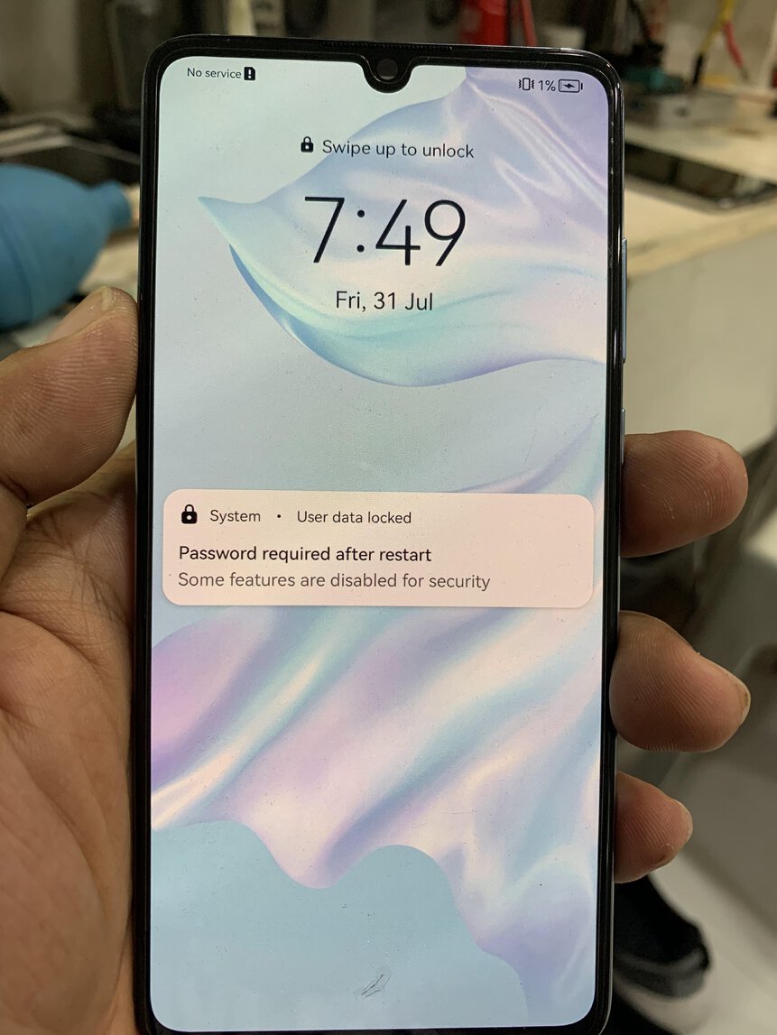

Huawei P30 Sudden off pero mag turn on pag pinahinga
Mag on sya pero few minutes after mag off na at kailangan palamigin para mag turn on ulit
kung ang unit mo ay may same behavior?!

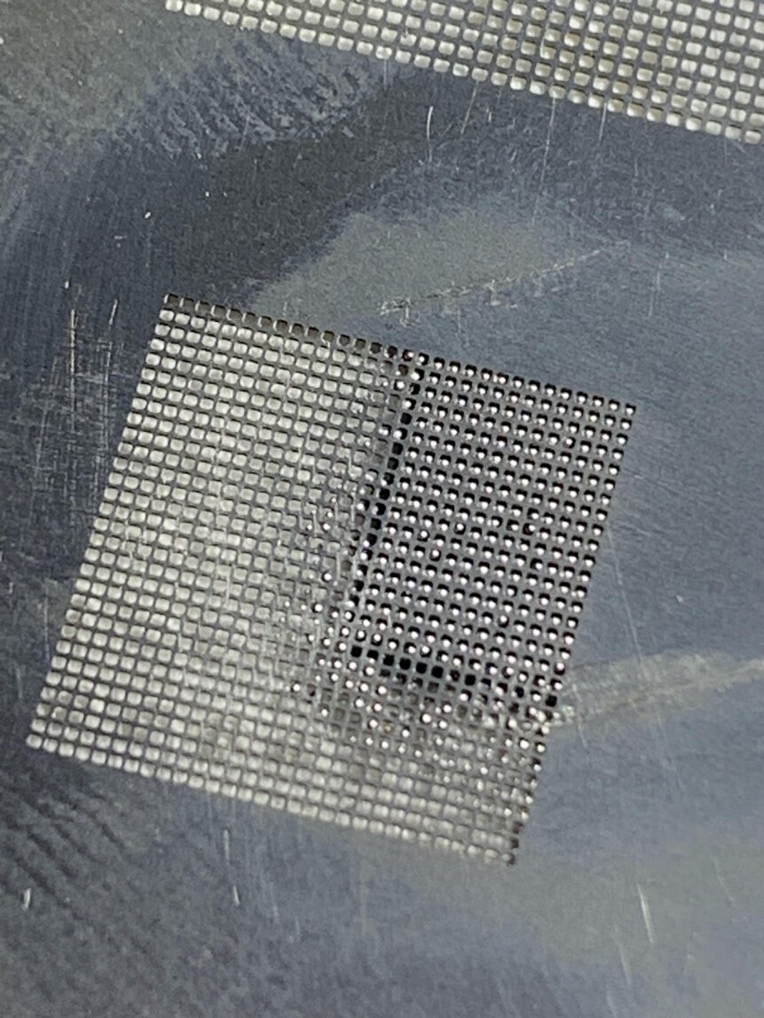

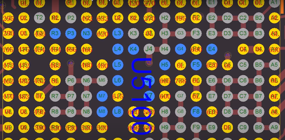

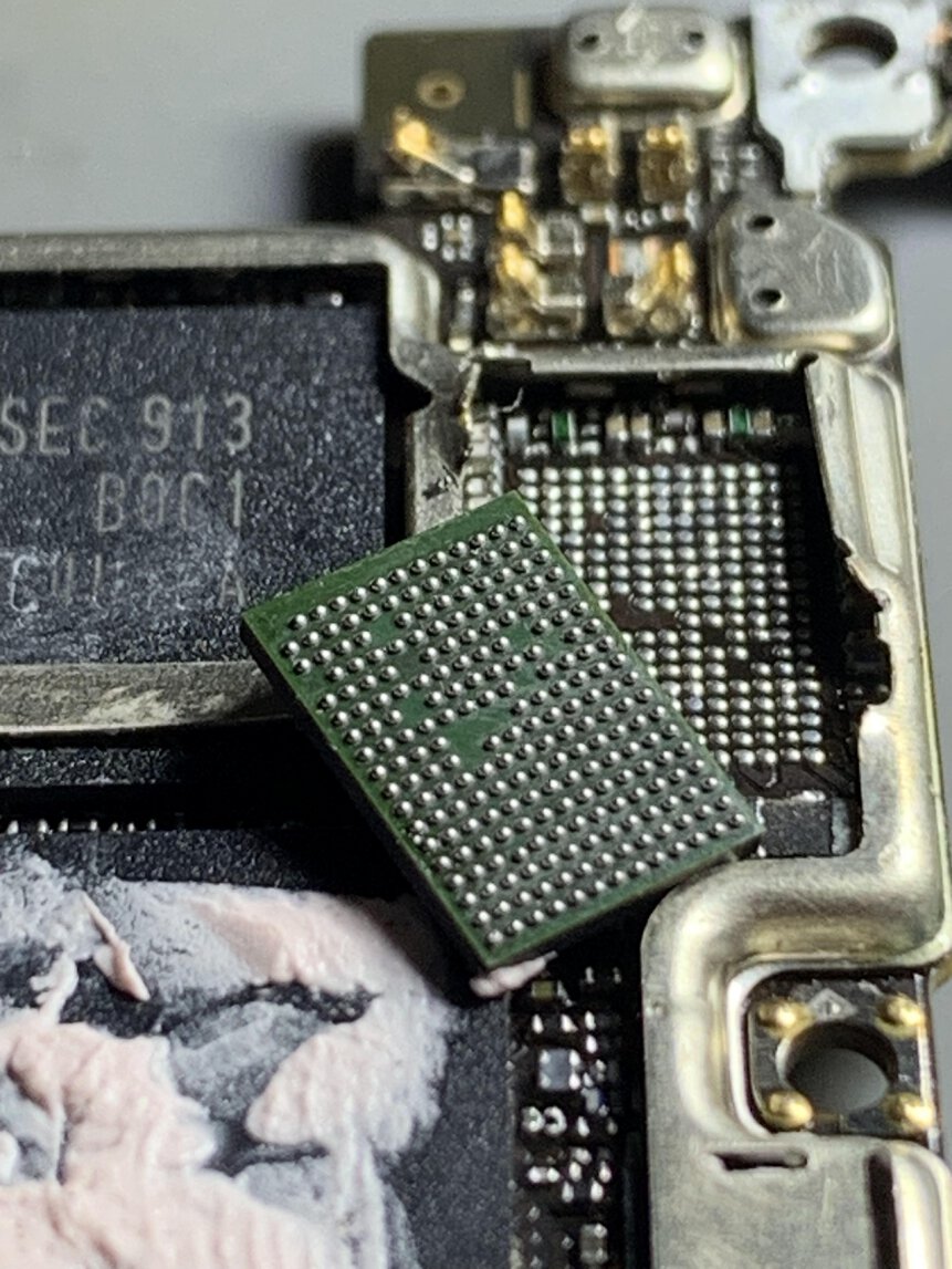

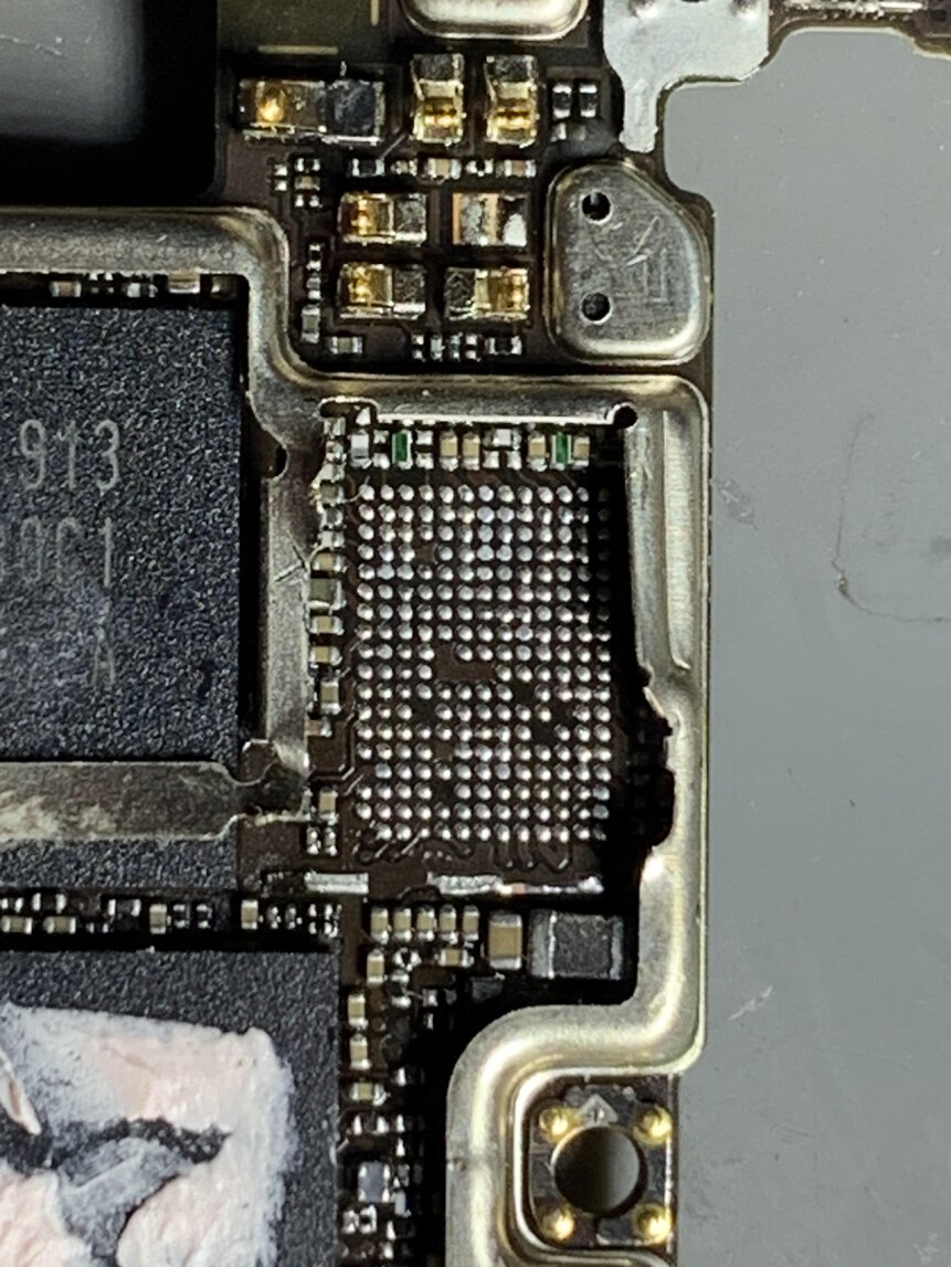

You have a case of a cold soldered wifi ic ( no need to replace the ic)
Remove wifi ic reball and check resistance of the pads of the board before installing it back
wala akong reballing plate kaya universal na lang muna
done
