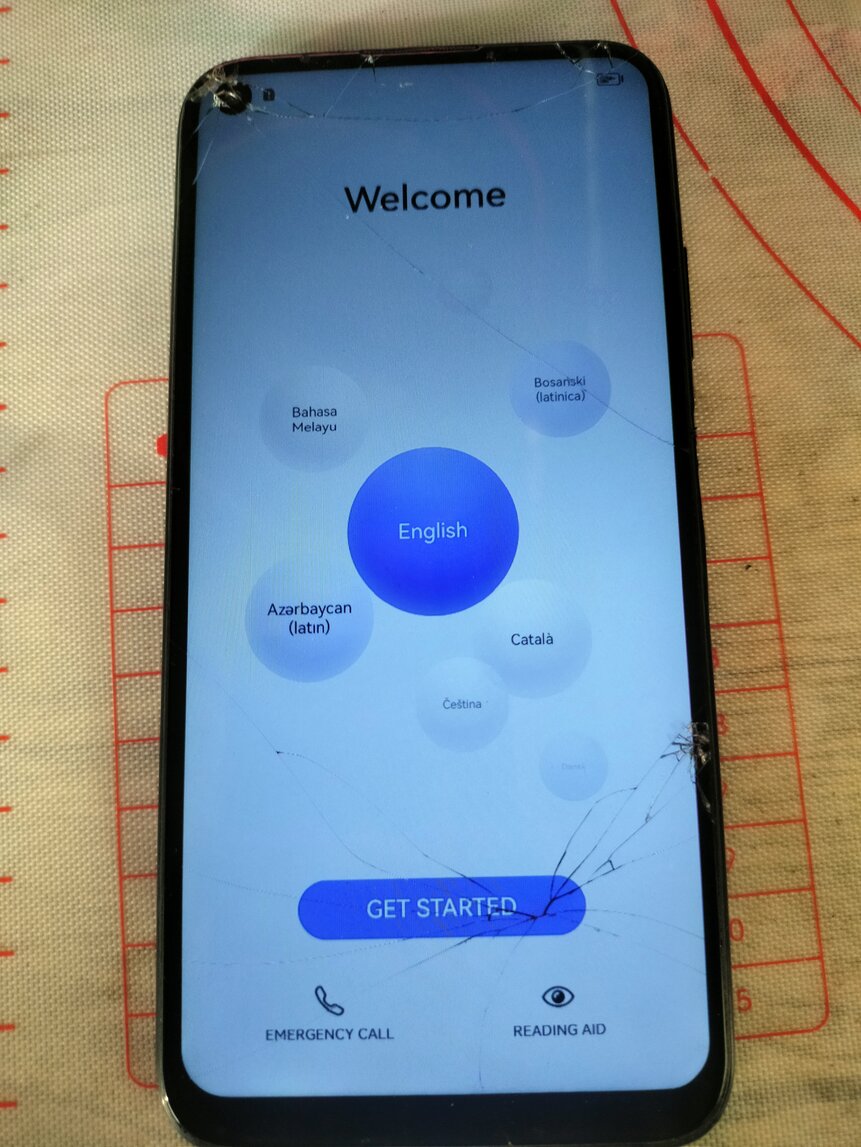

and this is the tools i used
problem of phone password
Hard reset in manual, but cannot type yes in recovery mode cos LCD not orig
Decided to flash:
go to recovery mode
press power button and Volume up
> Update Mode > Memory Card /OTG update mode.
Now wait for 4-5 minutes flashing until process is completed.
Once the process is done, you will see Update Success, but software failed as you see in picture
The device is restart and hang 2-3 minutes
after that hang finish and its done
and luckily no Huawei id and Bypass FRP Huawei P40 lite JNY-LX1.
done
Device name Huawei nova 7i.., i think this is the reason why Software installed failed
tanx for watching...
