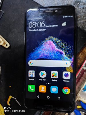

naka password nung dumating kaya hard reset muna volume up + power on ,then clear data.

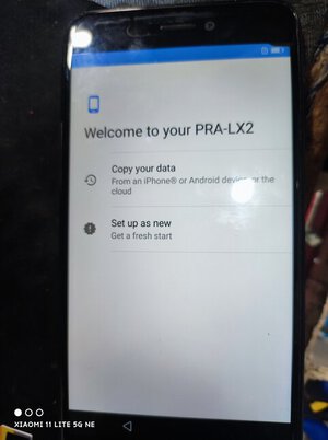

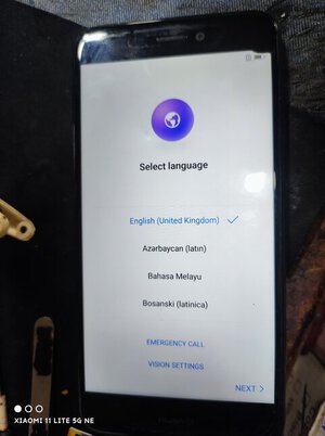

after hard reset my factory reset protection(frp)

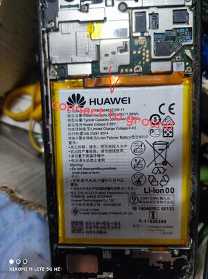

1. baklas unit for tp (nasa baba)
2. saksak unit sa pc (usb com 1.0)

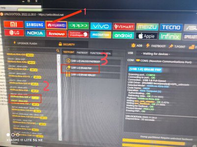

3. open unlocktool select kirin 659
4. hit erase frp
5. wait hanggang matapos
then done
