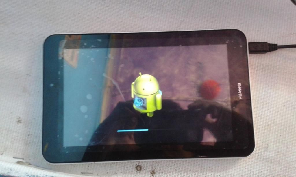

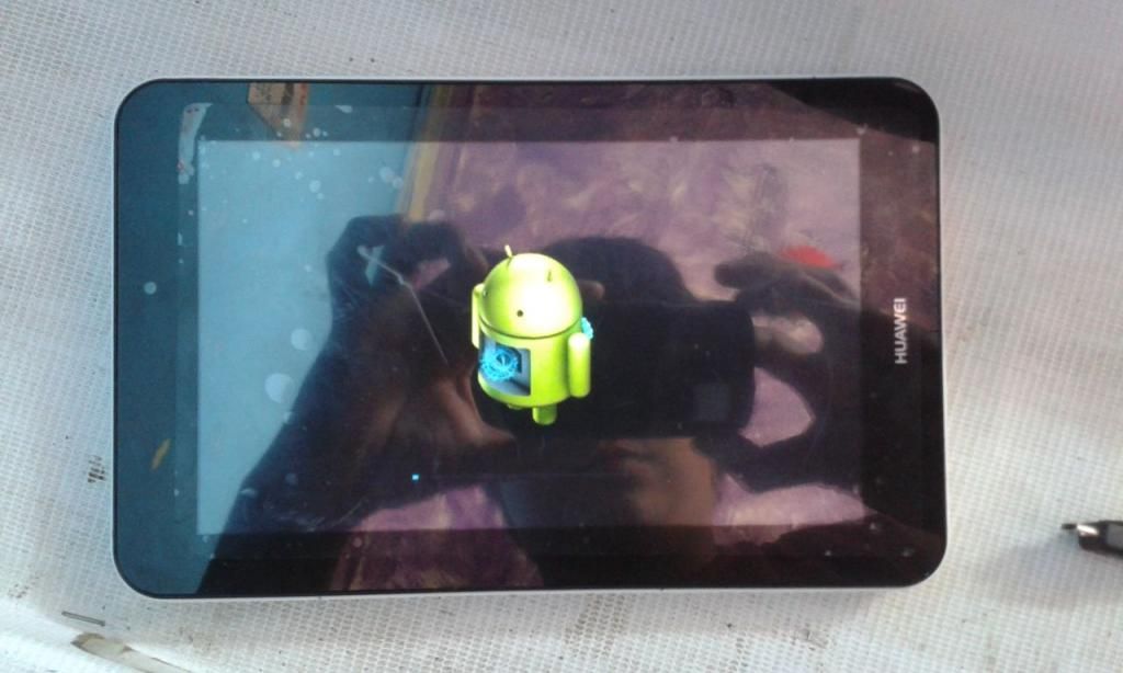

action taken:
1.hard reset pero ayw pumasok,
2.download firmware or files here : FIRMWARE
3. extract the files ,copy to memory card,at least 2gb
4.turn off the tablet,then press power on,vol up,vol down,pag nag vibrate release power button,wag bitiwan ang vol up at down till lumabas ung android recovery,then bitaw na wait till finish,then my message alisin ang memory then mag rebbot,lalabas huawei logo wait ng ilang minuto(mejo matagal)hanggat maari nkasaksak sa charger para di malowbat)

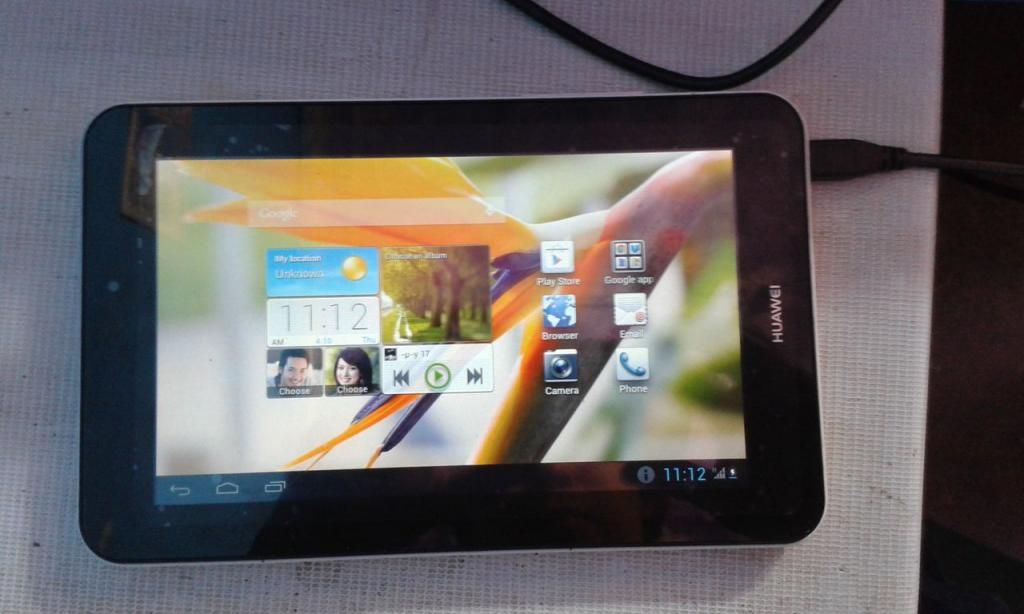

then pag kayari nun ok na..
thanks po sa mga nagbasa sana mkatulong................
