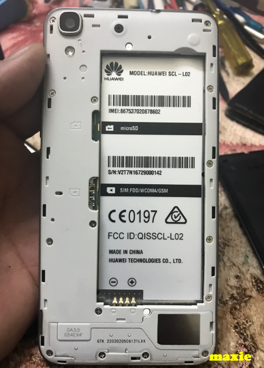

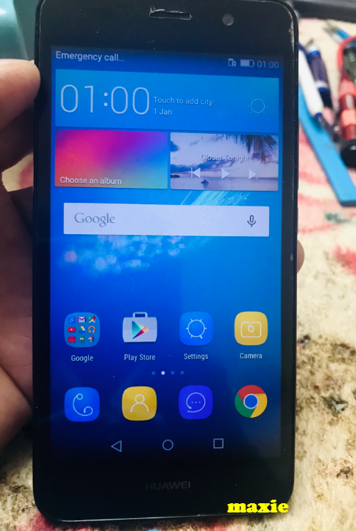

Unit: Huawei
Model: SCL-L02
Problem: FRP

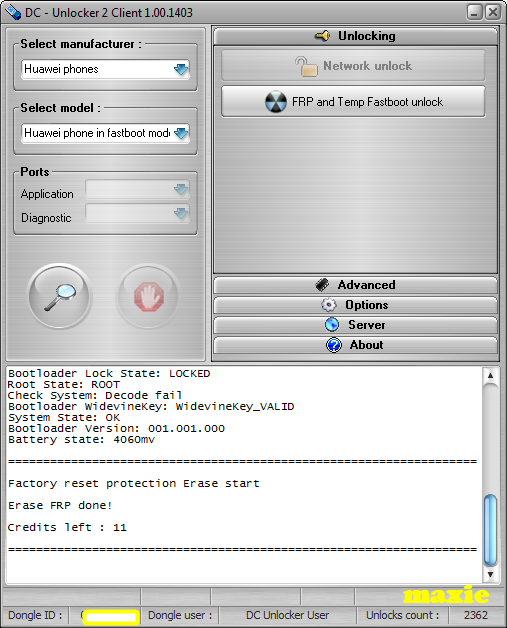

Solution: Unlock via DC Unlocker
Pictures:
Logs
DC - Unlocker 2 Client 1.00.1403
Detecting phone :
selection :
manufacturer - Huawei phones
model - Auto detect (recommended)
Found Phone : HUAWEI SCL-L02
Model : Huawei phone in fastboot mode
Serial NR. : V2T7N16729000142
Firmware : SCL-L02C900B140
FB LockState: LOCKED
widevine LockState: LOCKED
Bootloader Lock State: LOCKED
Root State: ROOT
Check System: Decode fail
Bootloader WidevineKey: WidevineKey_VALID
System State: OK
Bootloader Version: 001.001.000
Battery state: 4060mv
Factory reset protection Erase start
Erase FRP done!
Credits left : 11
finish
pasinsya na di ko na picturan yong stock sya sa google account
