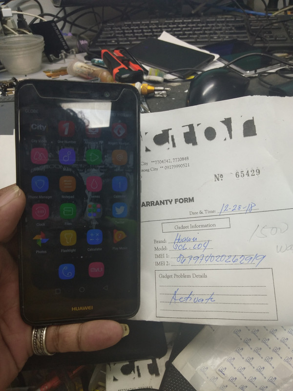

ilocos norte laoag city
no root required...
just on enable usb debugger on oem..

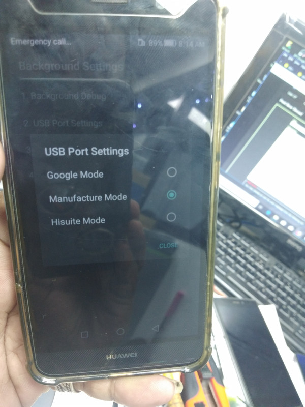

dial this number
dial "*#*#2846579#*#*"
elect background setting number 1
select usb port number 2
select mo muna yun hisuite mode

after install driver, balik ka sa unit select mo naman manufacture mode

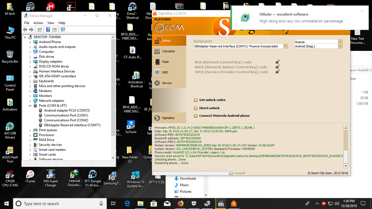

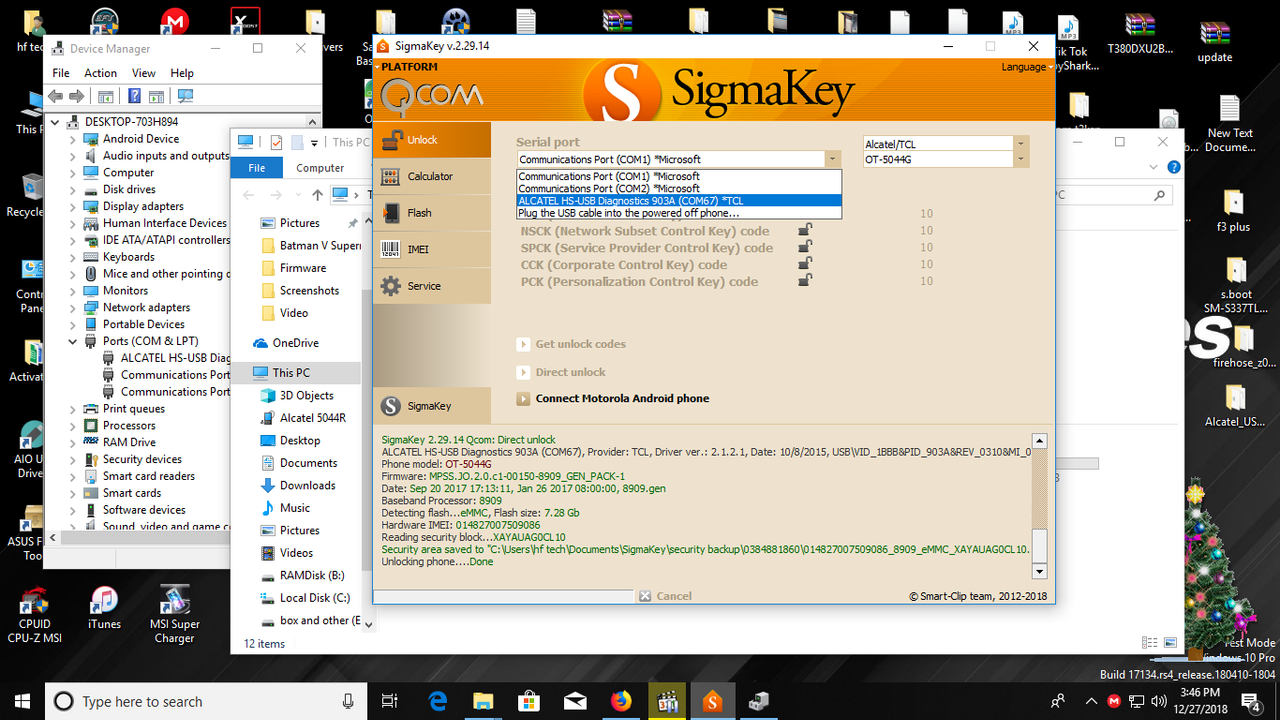

now open sigma
go qualcom tab
check picture
free photo posting
then hit direct unlock ...

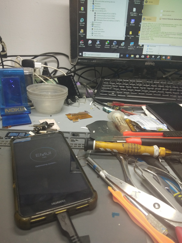

wait mag reboot ang unit at mag rereset ng ganito
hanggang mag normal 2 times mag gaganyan...
eto na finish product..
