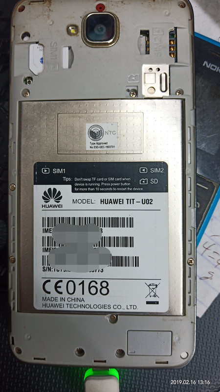

REFERENCE Huawei TIT-U02 FRP

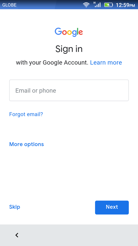

History : Nireset at di alam ang google Account
Procedure:
1. Connect to Wifi

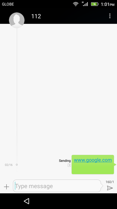

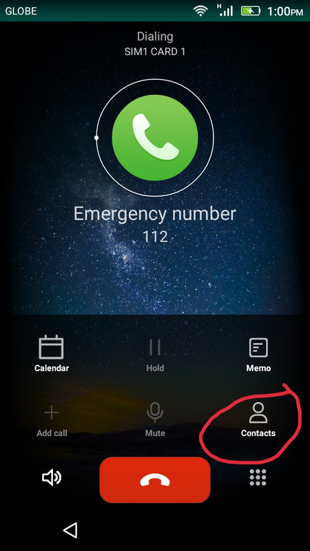

2.Go to Emergency Call at Dial Emergency Number

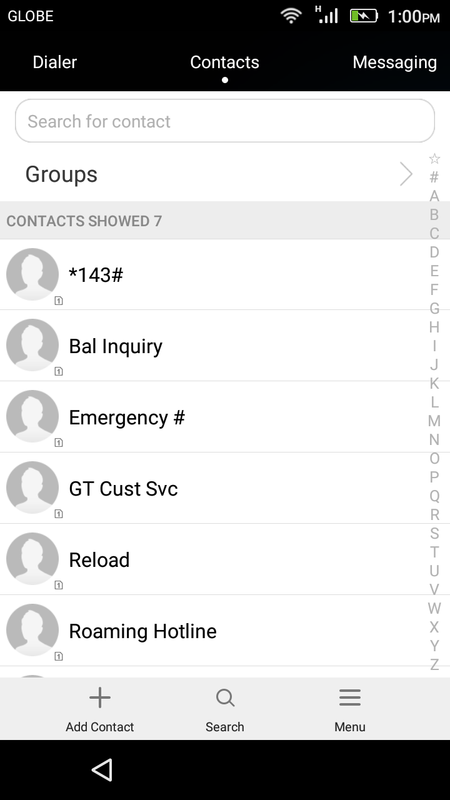

3. Click Contacts

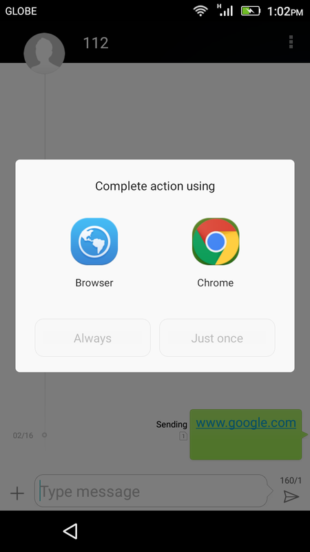

4.Cick Messaging at magsend gaya nito
5.Then Click mo yong www.google.com at Select Browser

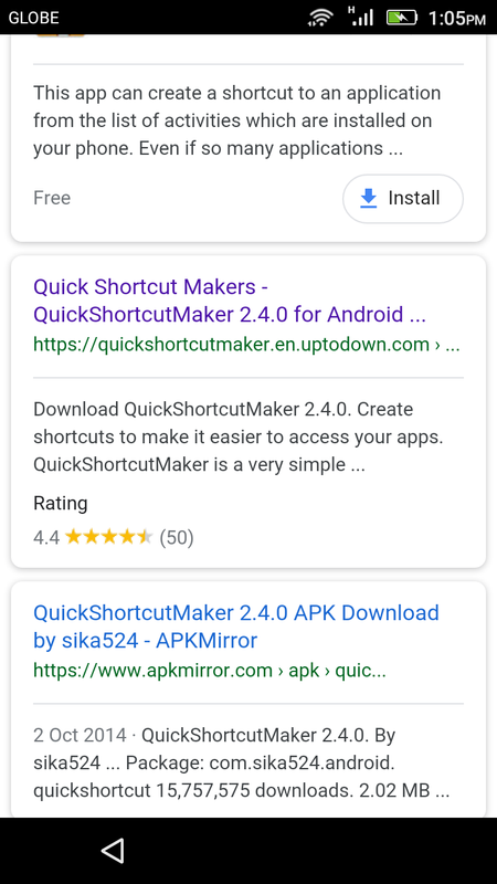

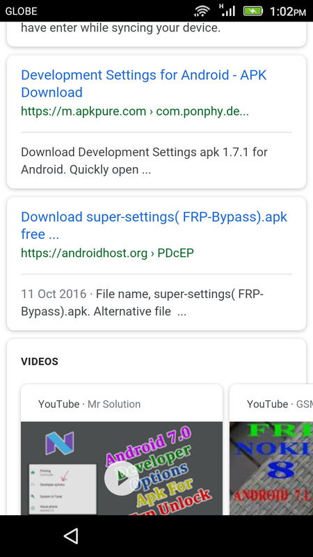

6.Search mo sa Browser , Download at Install SHortcutmaker and Development Setting apk

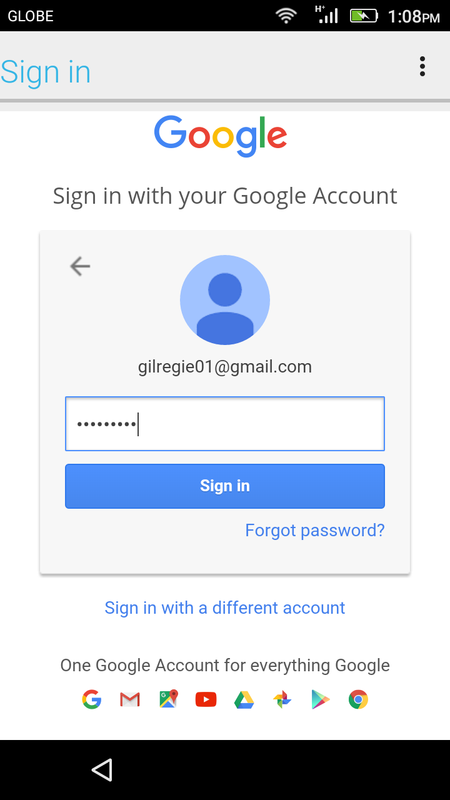

7.Open ShortcutMaker and login Google account

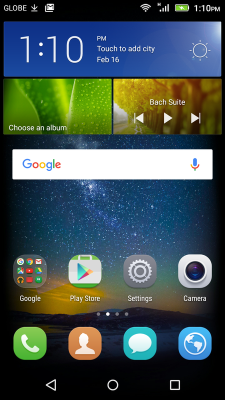

8.Restart and Setup..
9.Reset(Optional)
Finish product:
