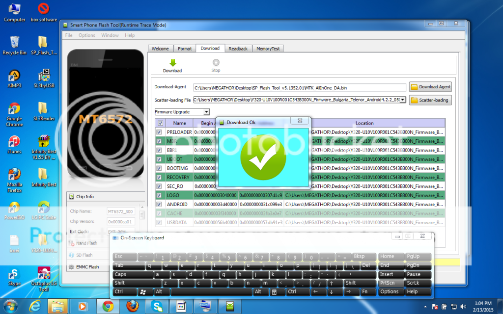

sinubukan ko gawin baka sakali8->
y320-u10 blank imei....pero di ko na nakuhanan ng pic nung naka blank imei pa...
pero sure nmn ito na nagawa ko=))
first download this firmware http://www.mediafire.com/download/apixrpyl7bzs8td/bboyskie+y320-u10+4.2.2.exe
and the flashtool and the driver....meron na kayo nyan cguro
and then pagnatapos na mag download ang firmware...
open flashtool put the firmware and then click download pagkatapos maclick......
saksak mo micro usb sa pc...and then sa phone...automatic na madetect yAN.....dapata nakalagay battery...
and wet until finish.........DONE:x
katibayan...
finish product::-*
thanks for viewing....:x
