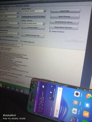

Nareset ni tumer kaso nakalimutan na nya ang kanyang Google Account.
Steps:
1. Download this DA File first. Credit to the original owner.
https://bestflashfile.com/huawei-mya-l22-da-file/
https://androidfilehost.com/?fid=14655340768118454910
2. Open NCKDongle AndroidMTK 2.5.6.2
3. Click Settings tab, at sa Custom Loader click Select Costum Loader at i-load mo yung na-DL mo sa taas na DA_SWSEC_Huawei_MYA_L22.bin.
4. Click mo ang Service tab at i-click mo ang Reset FRP.
5. Plug mo yung phone na naka-power off. Walang boot key. Hintayin na lang matapos at kusang mag restart si phone.
6. Done..Bypass na ang FRP :)
See photo for proof, diko na nakuhanan ng photo yung mismong cp at nagmamadali si tumer.
Sana makatulong sa tahanan :)
