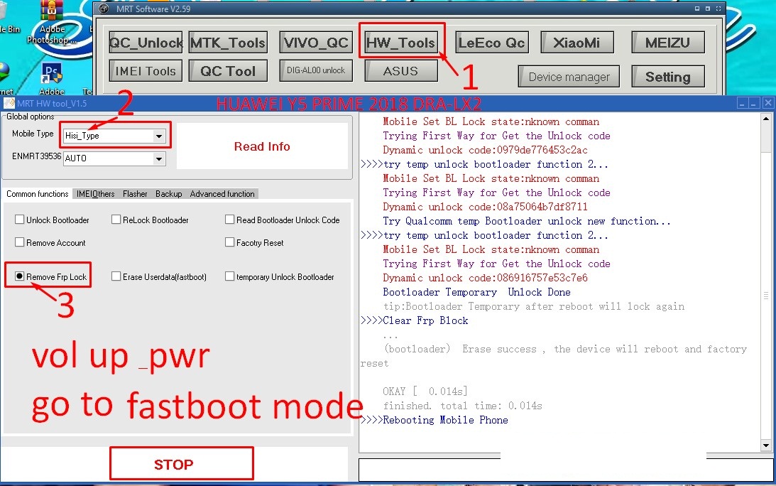

PROBLEM: forgot pattern
PROCEDURE:
-open MRT_2.59
-unit must be on fastboot mode
(pwr&vol up)
-click HW_Tools
-model type: Hisi_Type
-remove frp
-start
-connect usb cable
