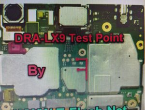

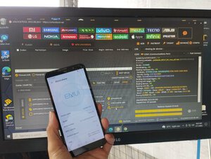

jhessell Registered Joined Sep 8, 2014 Messages 161 Reaction score 109 Points 1 Location Brgy. Muzon, San Jose Del Monte Bulacan Jul 11, 2022 #1 Huawei y5p dra-lx2 Issue: Huawei i.d 1. Open unlocktools 2. Select : MTK module 3. Select : SPECIAL 4. Select : HW Remove id 5. Test point and connect USB cable 6. wait until DONE Sana Po makatulong
Henzoboy Premium Account Joined Aug 31, 2021 Messages 77 Reaction score 37 Points 201 Location Mati city Davao Oriental Nov 22, 2022 #2 tested dol thanks
samhel12 Chapter Officer Joined Jan 25, 2019 Messages 326 Reaction score 270 Points 151 Location caloocan monumento northmall Feb 26, 2023 #3 tested sir. salamat
