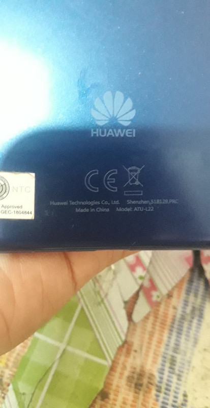

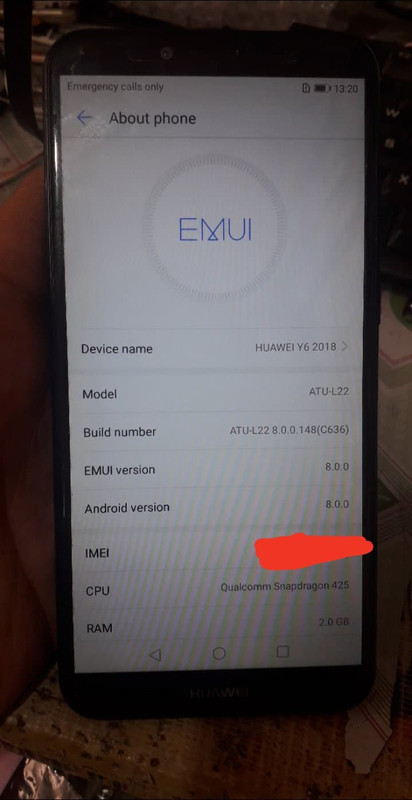

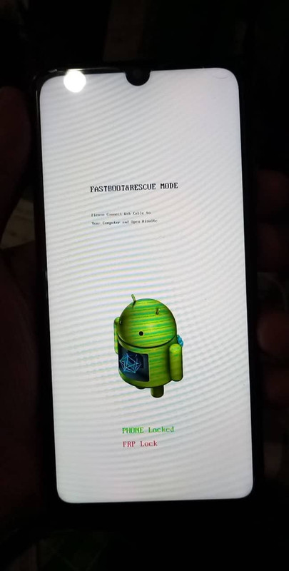

huawei y6 2018 ATU-L22

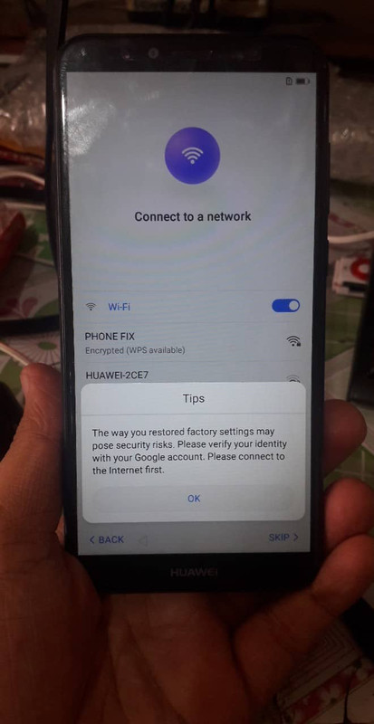

problem frp (google account )
done by MRT dongle

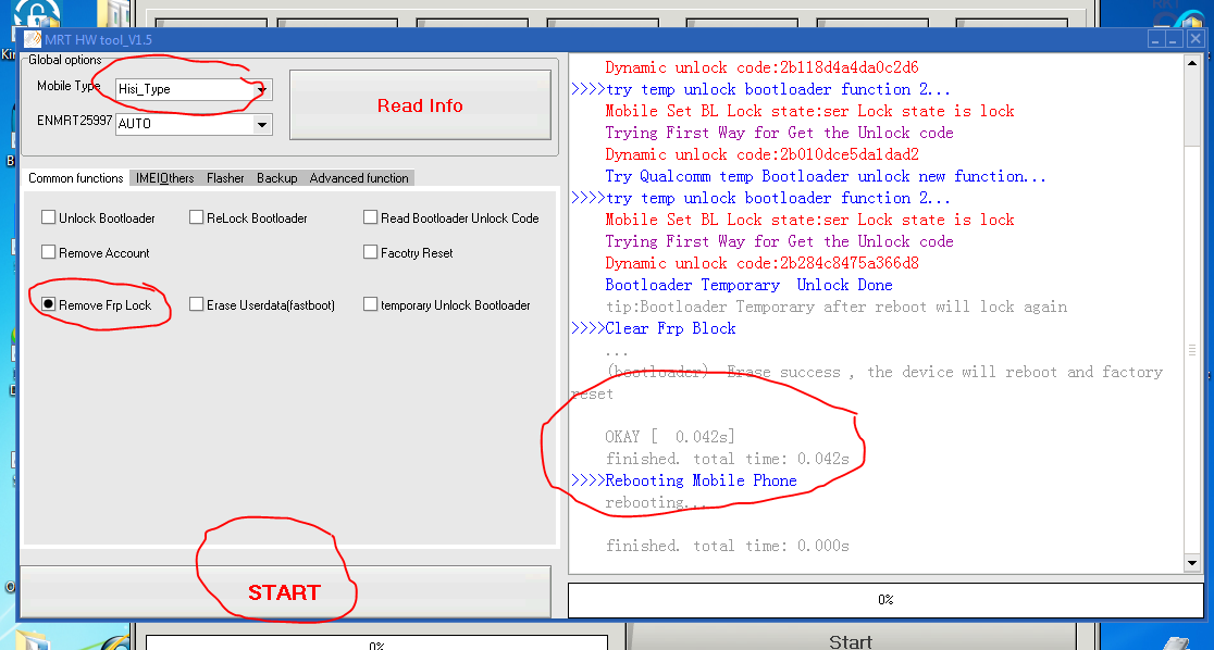

procedure
Open MRT SOFTWARE
Select HW TOOLS
Select Hisi type
Select REMOVE FRP LOCK
Put in fastboot mode the cp
by using insert usb then volume down and power switch
Install usb driver if needed
Then click START
then follow
screenshot
done
finish na
