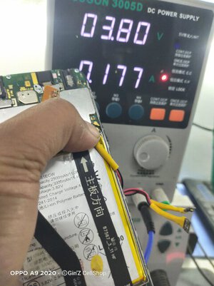

1st step i try to check on rps if shorted ba or may leak ang mnotherboard.
ayun may leak nga (0.177mA)

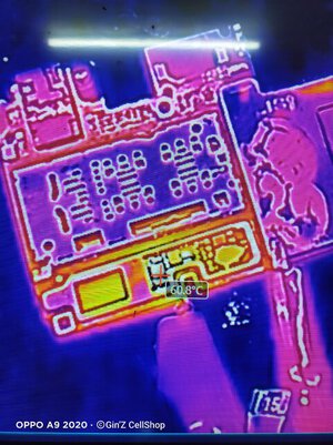

2nd step pang mabilisan, silip agad sa thermal cam.

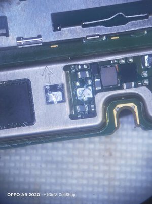

ayun kita na ang salarin, diode lng pla (no need na palitan ang anode kasi nasa ground lng nman) :cool:

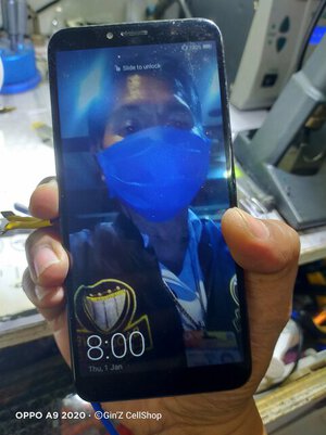

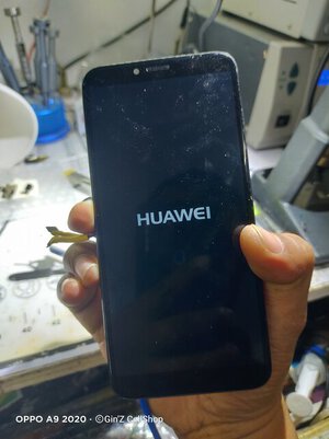

3rd step assemble na unit at testing sabay singil nang bayad :cool:
finish product.
