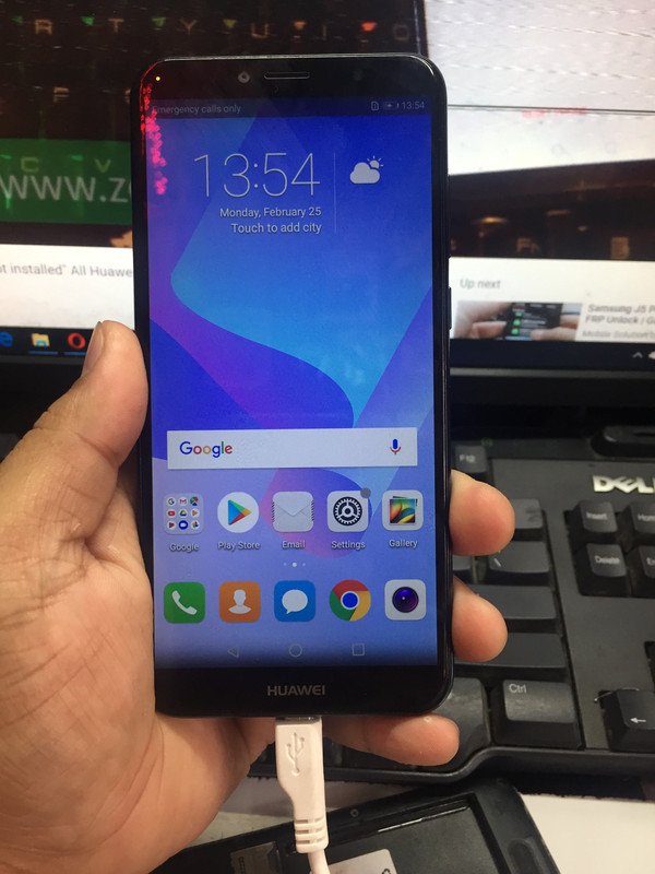

SHARE KO LANG SA INYO MGA MASTER HUAWEI FRP UNLOCK NEW METOD 2019
KAHIT MAKA PASOK KANA SA SETTING DIMO MA INSTALL ANG APK BYPASS TOOL
LAHAT PURO SA MRT/SIGMA/ETC.... WALA TAYU NYAN.. PWD RIN SA ONLINE VIA IMEI .
PERO SAYANG ANG KITA NATIN KUNG MAY KAHATE PA KAYA SINUKAN KO ETRY LAHAT
DI NAMAN NABIGO..
PROCCEDURE :

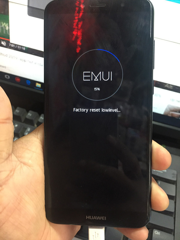

MAKE FACTORY RESET BY PRESSING VOL(UP/POWER..TYPE YES .
#CONNECT TO WIFI THEN RESTART. .
#ON SCREEN TAP 2 FINGGERS IN 6SECONDS LALABAS NA C TALKBACK AFTER THAT

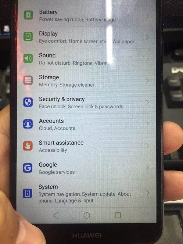

ALAMO NA IF TECH... KA JUST LOG IN TO (EMAIL/HOTMAL.. TAPOS PASUKIN MO NA C SETTINGS WALA KANG EDODOWNLOAD NA KAHIT NA ANUNG APK BYPASS ...

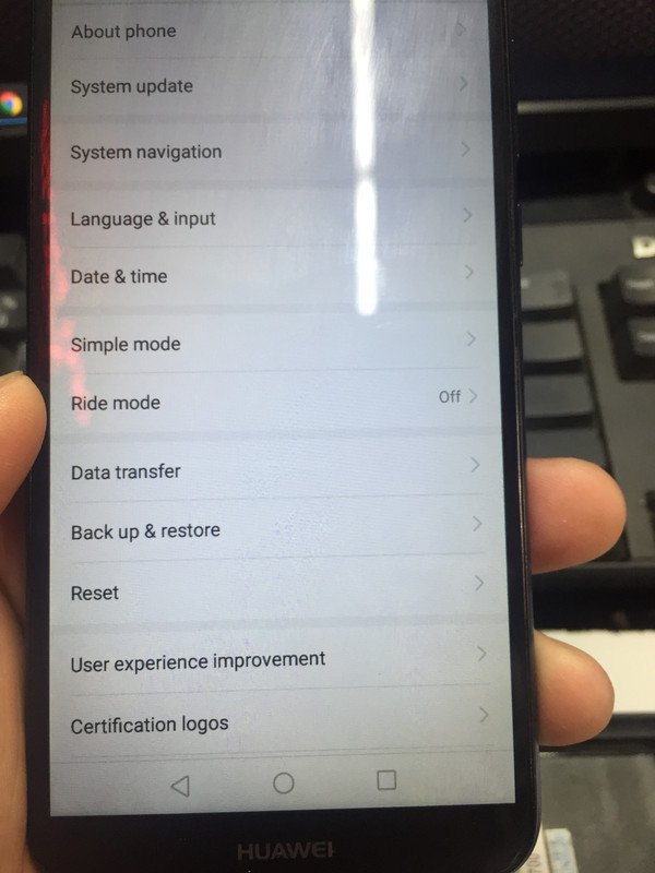

###PUNTA SA (SYSTEM) PINAKA BABA..

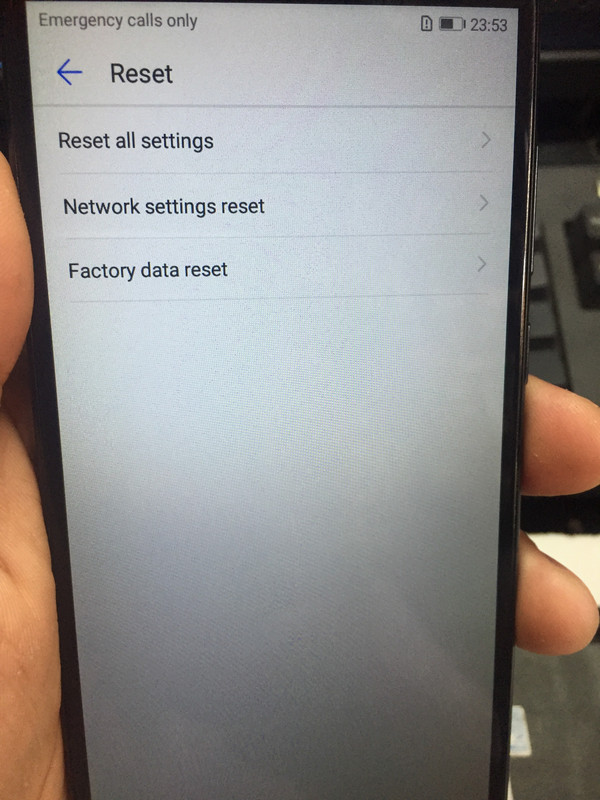

##tapos ponta ka sa reset
#reset all settings) (note: not factory reset ! sa pinakataas lang after that maual reboot
then bypass FRP na sya direct na sya sa menu .. now do factory reset on settings ..
##ok na po sya 1000% tested no tools no credit:
sana maka tulong :)
