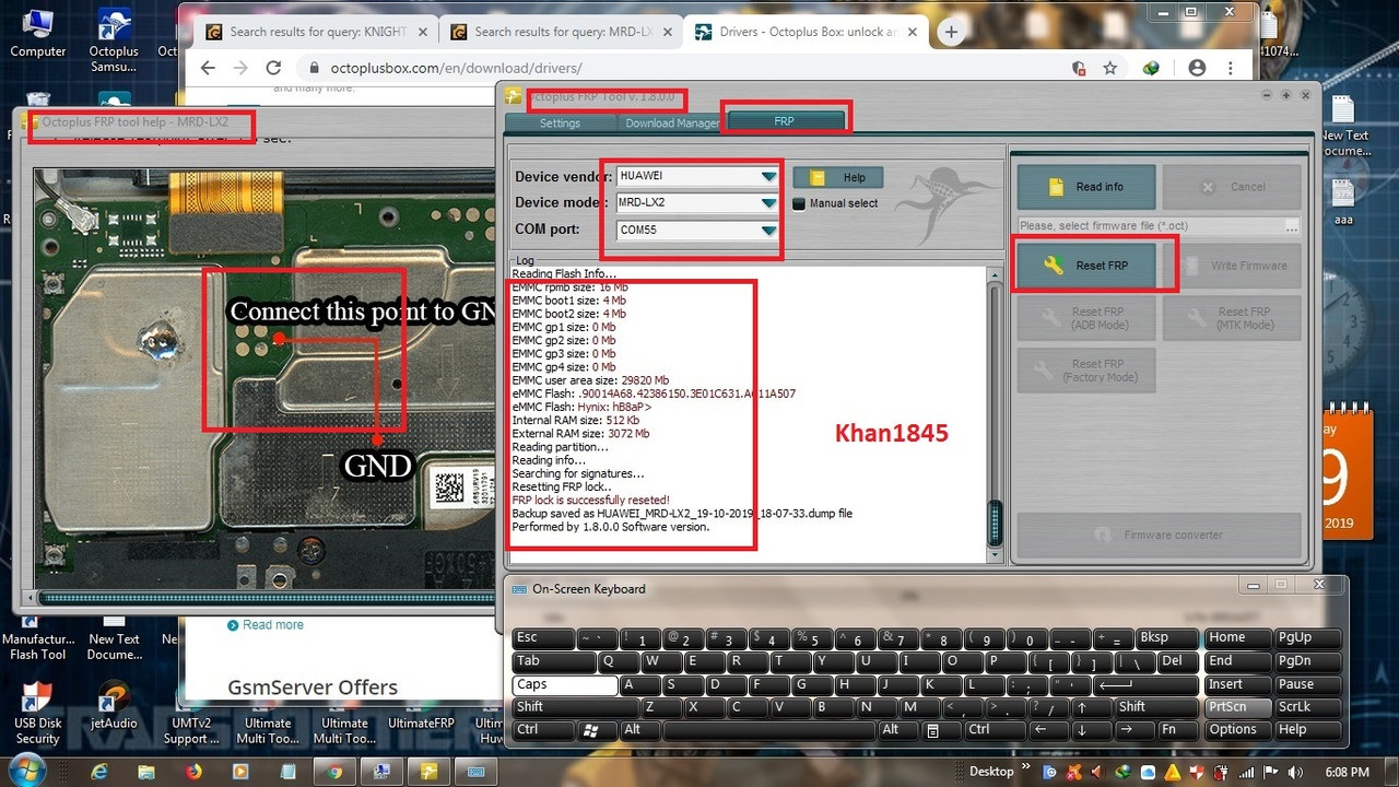

MODEL: HUAWEI Y6 PRP MRD-LX2
PHONE STATUS: GOOGLE ACCOUNT AKA FRP
TOOLS: 1- OCTUPLUS BOX
2- FRP TOOL
3- TWISER
PROCEDURE
WORK JOB
LOG'S
Platform: HUAWEI
Selected model: MRD-LX2
Put the phone into Brom mode:
1. Attach testpoint as shown in Help manual;
2. Connect USB cable;
3. Release testpoint after 3-5 seconds.
Searching for a phone. Please wait...
Found phone on COM10
Detecting Chip Version...
HW Chip: MT6761: 0717.0000
HW Version: 8A00.CA01.0200.0000
Connecting...
Brom Version: 05
BootLoader Version: FE
Sending auth...
Sending Auth Data...
Target Config: 0x000000E5
Searching Download Agent...
Selected DA: MTK_AllInOne_DA_v3.3001.2018/10/18.17:38_452898, n.1
Sending Download Agent...
DA sent successfully
Initializing DA...
Synchronizing with DA...
Mobile Status: SYNC
Mobile Status: brom
Sending BootLoader Info...
Initializing Memory Flash..
Initialization successfully completed
Sending loaders...
Mobile Status: SYNC
Reading Flash Info...
EMMC rpmb size: 16 Mb
EMMC boot1 size: 4 Mb
EMMC boot2 size: 4 Mb
EMMC gp1 size: 0 Mb
EMMC gp2 size: 0 Mb
EMMC gp3 size: 0 Mb
EMMC gp4 size: 0 Mb
EMMC user area size: 29820 Mb
eMMC Flash: .90014A68.42386150.3E01C631.A611A507
eMMC Flash: Hynix: hB8aP>
Internal RAM size: 512 Kb
External RAM size: 3072 Mb
Reading partition...
Reading info...
Searching for signatures...
Resetting FRP lock..
FRP lock is successfully reseted!
Backup saved as HUAWEI_MRD-LX2_19-10-2019_18-07-33.dump file
Performed by 1.8.0.0 Software version.
DONE
