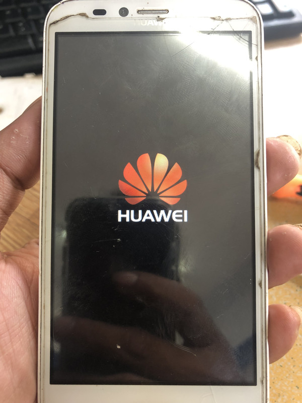

PROBLEM-HANG LOGO
TOOLS-CM2QLM
FIRMWARE-http://www.mediafire.com/file/4gi8so7x6889n97/Huawei_Y625-U43_V100R001C526B100_4.4.2.zip
HANG LOGO
FLASHING THRU SD CARD NO LUCK
FLASHING THRU USB NOT DETECT AUTOMATIC ON
FLASHING THRU TP DONE

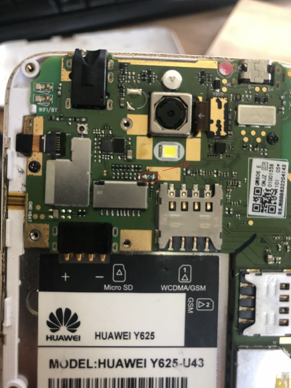

DISASEMBLE UNIT SHORT TP, DISCONNECT AFTER DETECTED

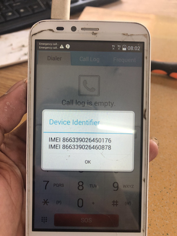

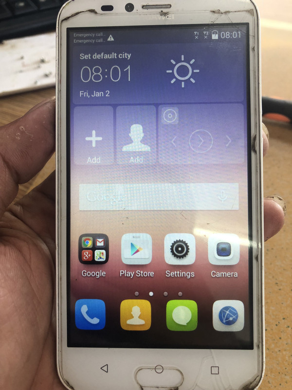

DONE...THANKS
Maranming salamat boss tested file po...
