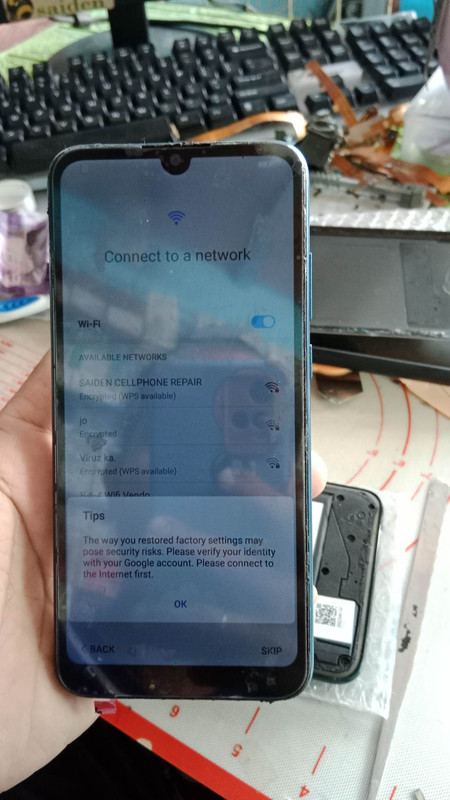

HUAWEI Y6PRO 2019
FRP SULOSYON

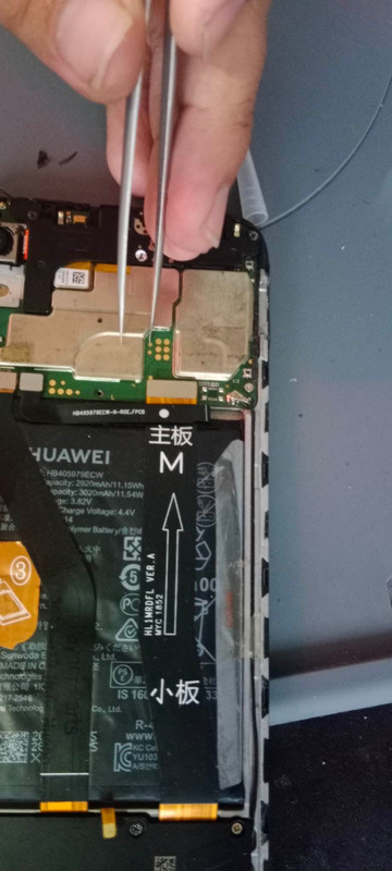

NEED PO BAKLASIN ANG PHON
PARA TEST POINT BASIC LANG

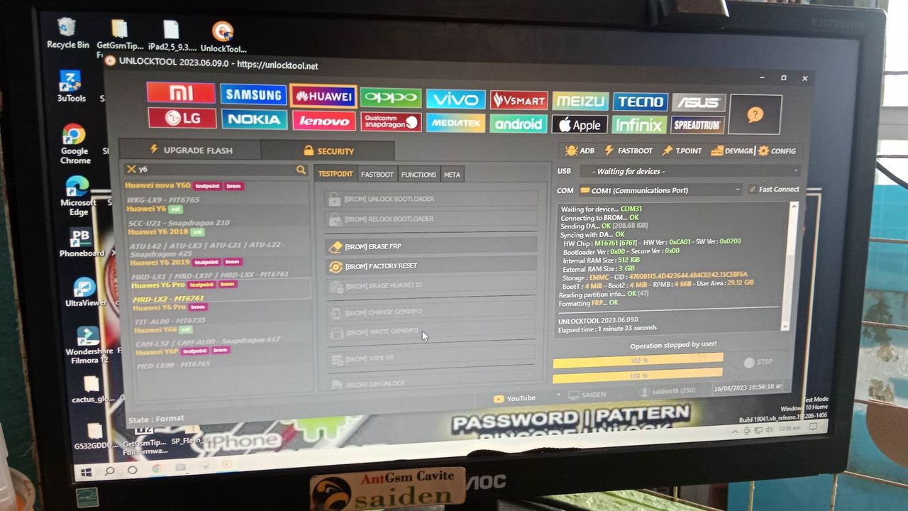

OPIN UNLOCK TOOLS
CLCIK MO HUAWEI TAB
HANAPIN MO Y6PRO 2019
CONECT MO USB CABLE TP MO
CLICK MO ERASE FRP
WAITING MO HANGAN MATAPOS

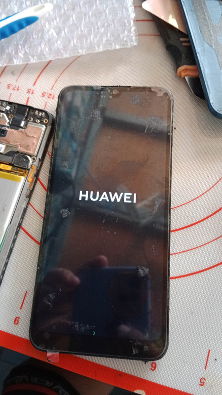

DONE
HUAWEI Y6PRO 2019
FRP SULOSYON
OPIN UNLOCK TOOLS
CLCIK MO HUAWEI TAB
CLICK MO ERASE FRP

DONE
