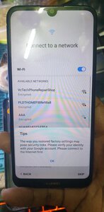

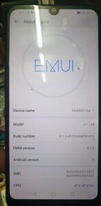

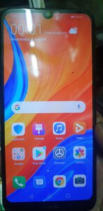

FRP PROBLEM

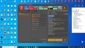

1.Open UnlockTool
2.Select: brand HUAWEI
3.Search: Huawei Honor 8A testpoint
4.Click: [BROM] ERASE FRP
5.Testpoint and Connect USB CABLE
wait it done

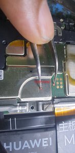

TP.
remove battery
Set UnlockTool
