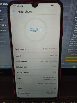

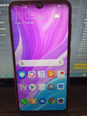

Huawei y7 2019 (DUB-LX3) FRP remove by unlocktool

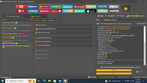

OPEN UNLOCKTOOL

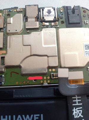

Diassembly unit
Disconnect batery
Short testpoint
Connect cable
Open huawei
Select model

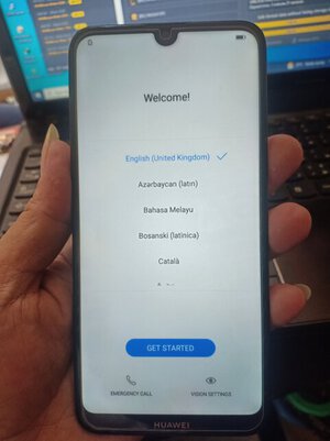

Then click erase Frp
