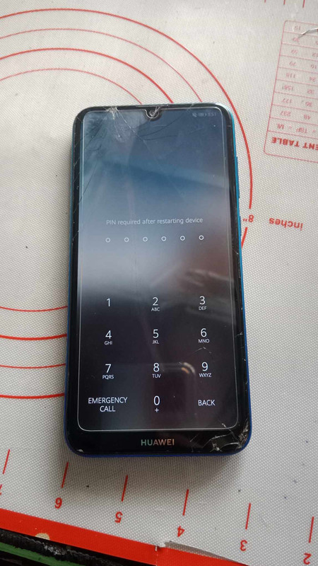

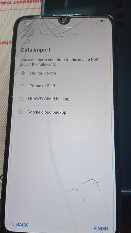

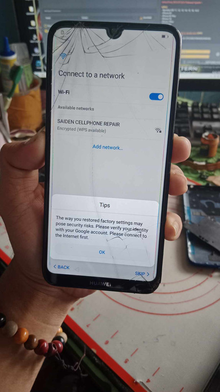

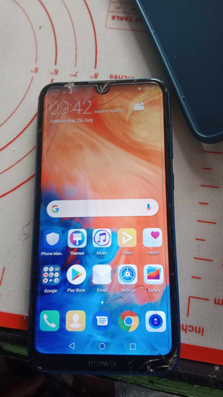

PROCEDURE MGA IDOL
SO TEST POINT ANG UNIT
NEED BAKLASIN PARA MATANGAL
NATIN ANG FRP NYA
HARD RESET MUNA PASSWARD NYA
PAG NATAPOS SAKA TIRAIN SA UT
ANG FRP NYA

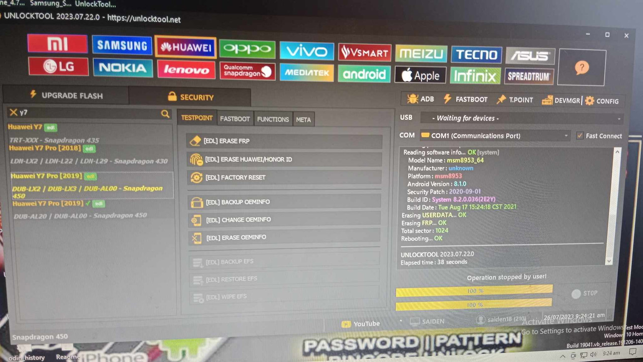

STEP 1 LOG IN UNLOCK TOOLS MO
STEP 2 CLICK MO HUAWEI TAB
STEP 3 SEARCH MO Y7 PRO 2019
STEP 4 READY MO USB CABLE MO

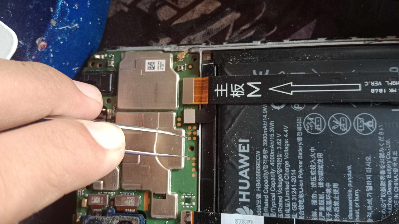

STEP 5 TP MUNA UNG UNIT MO REMOVE CONECTOR BATTERY

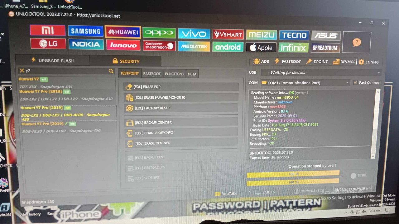

STEP 6 CLICK MO EDL ERASE FRP
STEP 7 CONECT MO USB CABLE
WAIT MO
HANGANG MATAPOS
DONE FINISH
100% WORKING! Salamat boss!
[EDL] ERASE FRP Selected Model : Huawei Y7 Pro [2019]
Code Name : DUB-LX2 | DUB-LX3 | DUB-AL00
Operation : Huawei Low Level Format
Authenticating... OK
Retrieving data... OK [128.5 KiB]
Initializing data... OK
Waiting for HS-USB QDLoader 9008... COM4
Connecting to device... OK
Handshaking... OK
Reading bootloader info... OK
Serial : 2180148497 SoC : [Snapdragon 450] [SDM450] [0x0009A0E1]
OEM : Huawei [0x0015] Model : Unknown [0x0000]
PK_HASH[0] : 6BC369511DA9CADB3A7AF61574F89DB3
PK_HASH[1] : 85003D6241BDD1FF573DBA61BF6AE119
Writing flash programmer... OK
Connecting to flash programmer... OK
Configuring device... OK
Firehose config : eMMC [Sector:512] [Target:4096] [Host:16384]
Reading partition map... OK - LU Count : 1
Reading software info... OK [system]
Model Name : msm8953_64
Manufacturer : unknown
Platform : msm8953
Android Version : 8.1.0
Security Patch : 2020-09-01
Build ID : System 8.2.0.036(2E2Y)
Build Date : Mon Aug 16 19:03:05 CST 2021
Erasing USERDATA... OK
Erasing FRP... OK
Total sector : 1024
Rebooting... OK
UNLOCKTOOL 2023.08.18.0
Elapsed time : 16 seconds
Handshaking... OK
Platform : msm8953
Erasing FRP... OK
Total sector : 1024
Rebooting... OK
