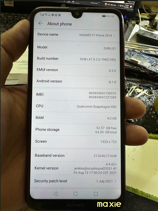

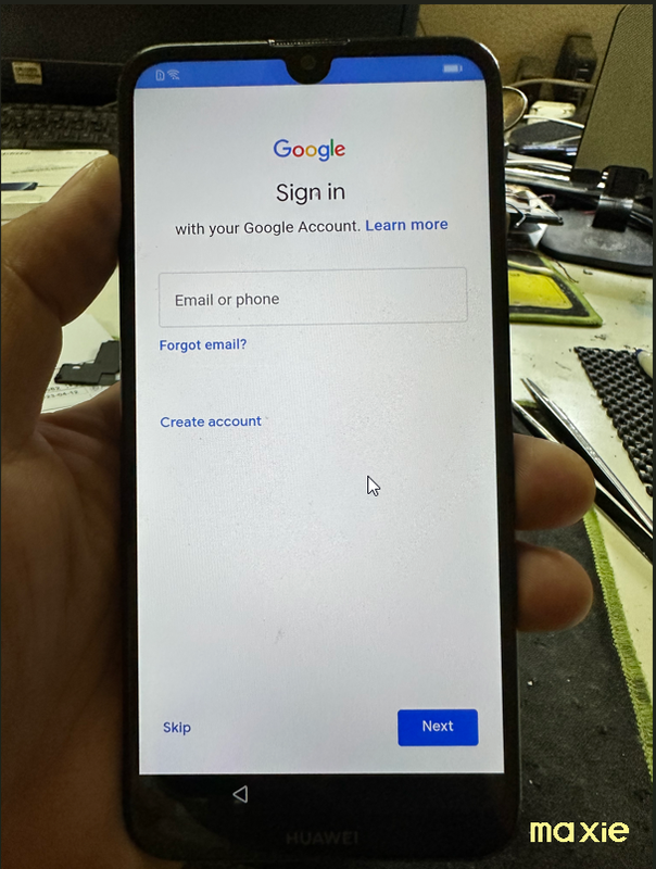

Hi
Unit: Huawei
Model: DUB-LX1
Problem: Google account or FRP
Solution: Unlock via Testpoit
Tool:

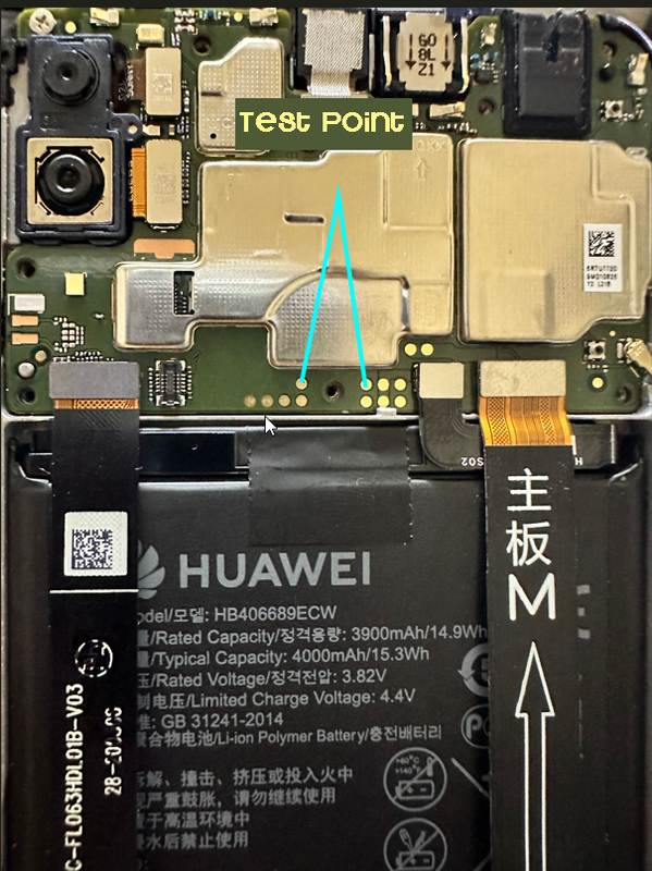

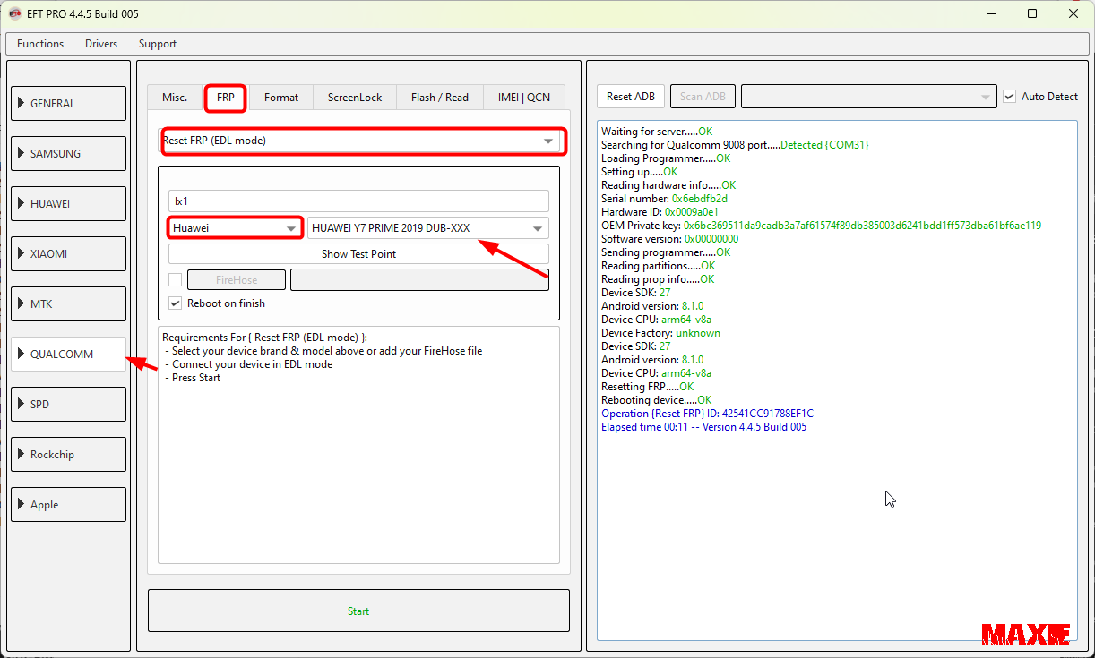

Procedure
- Dissasemble the mobile
- open EFTPro tool
- Qualcomm
- FRP
- Reset FRP (EDL MODE)
- Huawei
- Huawei Y7 Prime 2019 DUB-XXX
Waiting for server.....OK
Searching for Qualcomm 9008 port.....Detected {COM31}
Loading Programmer.....OK
Setting up.....OK
Reading hardware info.....OK
Serial number: 0x6ebdfb2d
Hardware ID: 0x0009a0e1
OEM Private key: 0x6bc369511da9cadb3a7af61574f89db385003d6241bdd1ff573dba61bf6ae119
Software version: 0x00000000
Sending programmer.....OK
Reading partitions.....OK
Reading prop info.....OK
Device SDK: 27
Android version: 8.1.0
Device CPU: arm64-v8a
Device Factory: unknown
Device SDK: 27
Resetting FRP.....OK
Rebooting device.....OK
Operation {Reset FRP} ID: 42541CC91788EF1C
Elapsed time 00:11 -- Version 4.4.5 Build 005
