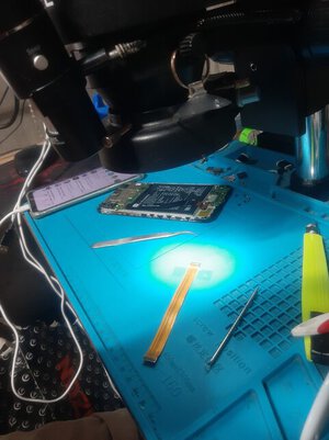

No sounds step 1: check speaker use tester ohm mode , good it has continuity
No sounds step 2: use tester diode mode test speaker line on main board , all in good readings.
No sounds step 3: test speaker line on charging board use buzzer mode then check from speaker line to fpc , both line has continuity.

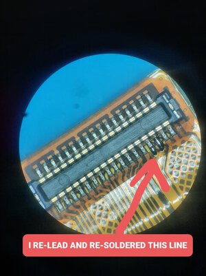

No sounds step 4: check fpc connector/FLEX use buzzer mode on tester check speaker line, Boom!!! kita na agad salarin (SPKR_DRVR_M) line no continuity. Flex issue see pic bellow .
NO service also fix after repair fpc/FLEX tsamba!!!!
