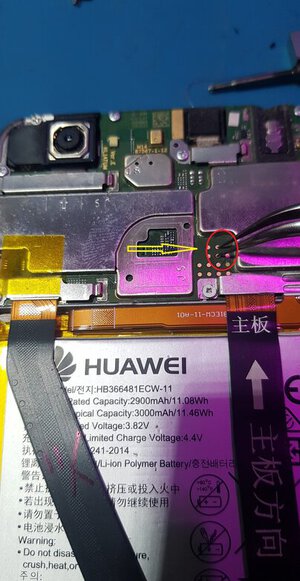

BAKLAS UNIT FOR TEST POINT

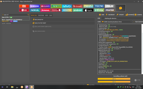

1 SELECT HUAWEI TAB
2 SELECT HUAWEI Y6 2018
3 CLICK (EDL-ERASE FRP)
4 TESTPOINT
5 SALPAK USB WAIT UNTIL DONE

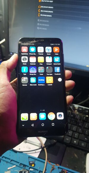

SALAMAT NEWBIE LANG PO :)
