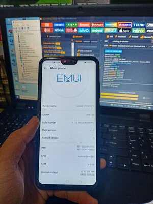

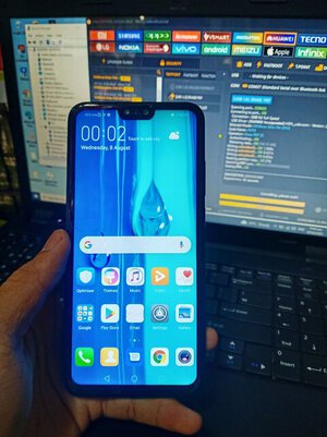

REFERENCE Huawei Y9 2019 (JKM-LX2) FRP DONE via TP/UNLOCKTOOL
Madz11
Oct 30, 2022
52
199
201
San jose del monte Bulacan

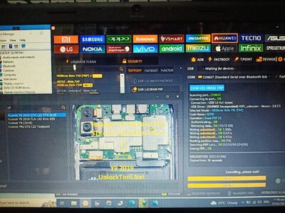

Procedure
1. Open UNLOCKTOOL
2. Click: HUAWEI Tab
3. Search: HiSilicon Kirin 710 [FRP] ✅
4. Select: [USB 1.0] ERASE FRP
5. disconnected ang Battery Connect Usb cable & Testpoint
Done God Bless sana makatulong :)
