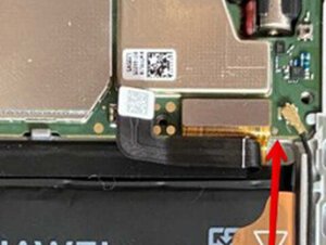

HUAWEI Y9S STK-L21 FRP DONE
Via OCTOPLUS FRP
ISSUE:: FRP
TOOL: OCTOPLUS BOX
SOFTWARE: OCTOPLUS FRP
PROCEDURE::
* open octoplus frp applocation
*select huawei brand/MODEL
* open unit for test point
*plug usb data cable and test point
* click FRP FACTORY MODE
*wait until finish
BOOM DONE..
Via OCTOPLUS FRP
ISSUE:: FRP
TOOL: OCTOPLUS BOX
PROCEDURE::
*wait until finish
BOOM DONE..
boss saan jan ang tp.?
