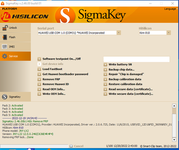

TOOL: SIGMA BOX, HARMONY CABLE
PROBLEM: HUAWEI ID ANF FRP
PROCEDURE
1. Download latest installer of sigmabox and install
2. Connect testpoint without battery to detect Huwie 1.0 in device manager . after detected back battery
3. in Sigmabox program services select kirin 810 and huawei 1.0 select huawei id remove / huawei frp remove
