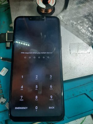

REFERENCE Huawie nova 3i password ayaw reset not working pero done parin ni unlocktool

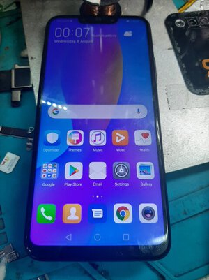

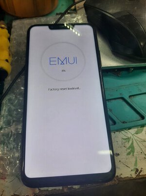

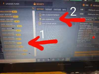

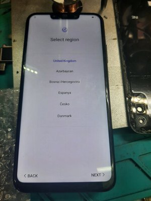

Action taken baklas unit para tp
select hisilicon kirin 710
Tapos hit mulang (usb1.0)erase frp
Tpos antyin molang mulang matapos
salamat.
