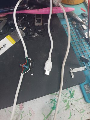

Baklas unit kasi need tp
Use harmony cable para madetect
Pagnormal cable ayaw ma detect

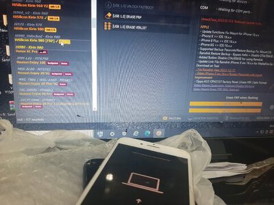

Open unlocktool
Click huawie tab
select hisilicon kirin980(FRP)
Click(usb 1.0)ERASE FRP

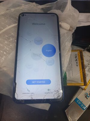

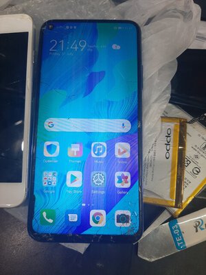

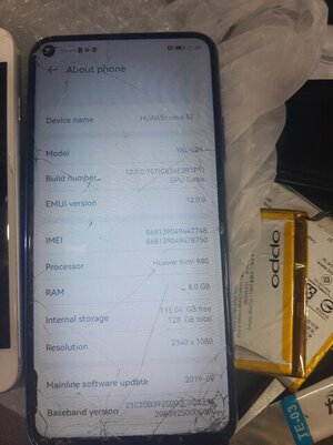

tApos wait mo nalang hangang matapos
Salamat
