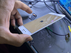

iphone 8 no power
procedure :

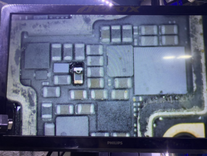

check batt vdd (0.523) shorted board
baklas unit then test vdd main (0.002) shorted line
apply insenso then salpak sa power supply

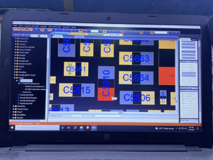

uminit si caps C5610 kaya removed caps then check vdd main (normal na)

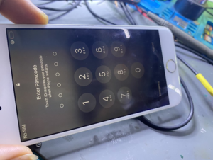

replaced caps then assemble
done dalandan like lang ok na 4 my efort
