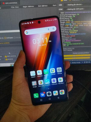

Baka may need ng reference sa inyo Infinix Hot 11s X6812B FRP or Password pwede using UnlockTool.

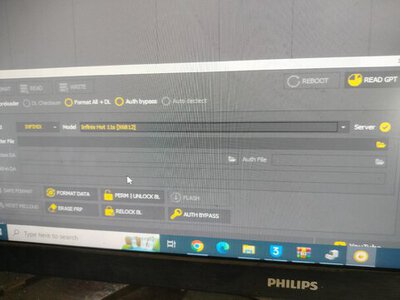

Tinry ko sa Infinix tab sa UnlockTool tapos X6812 (walang B) ayaw. Authentication error.
Hanap procedure wala din makita dito sa forum.

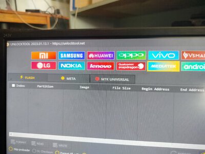

Open UnlockTool and go to Mediatek section tapos FLASH.
Check Auth bypass and Server tapos select Brand: Infinix Model: Infinix Hot 11s [X6812]

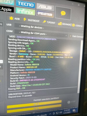

Turn off the unit tapos hold Volume Up + Volume Down then salpak sa PC. Then click ERASE FRP.
Kapag may password, FORMAT DATA muna bago ERASE FRP.
100% done by UnlockTool.
