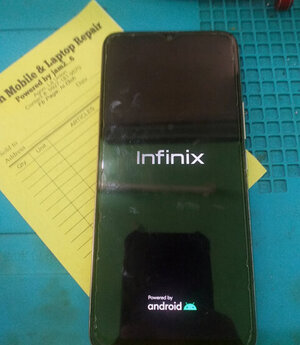

Infinix Hot 12i

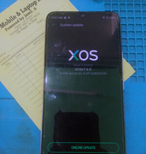

Problem

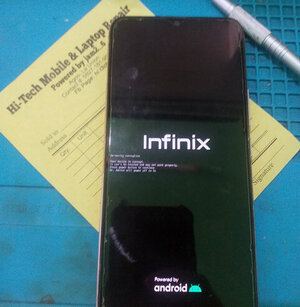

Start UP...
Your device is corrupt
Sulotion :

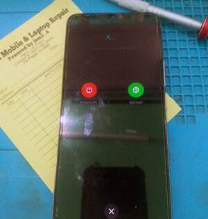

Press Power sw 5sec...
Boot...
Open Menu...

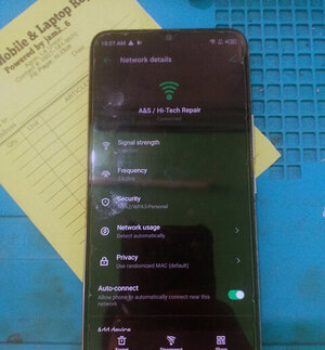

Connect to wifi...
Select Online Update...
Wait for install... Update...

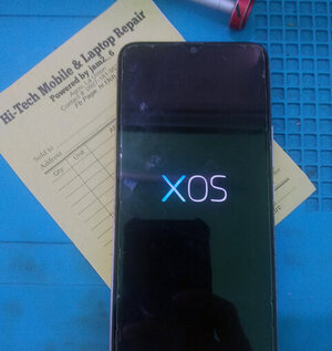

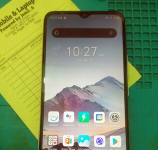

Restart...
Done...
Tnx for view sna makatulong po mga boss...
